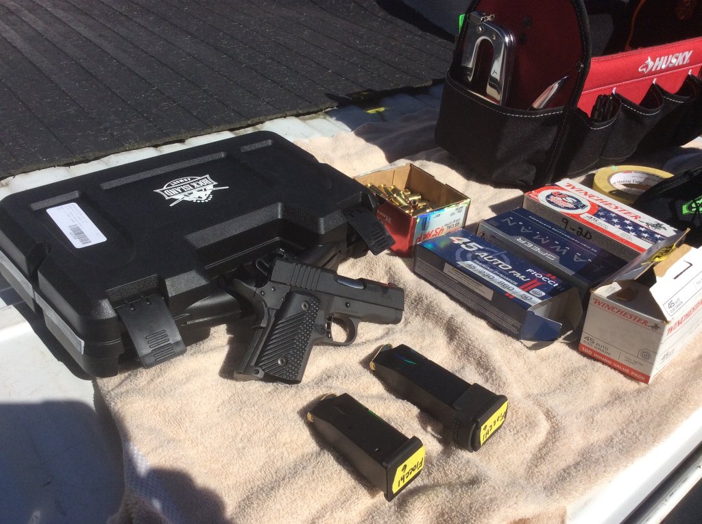

Very windy and chilly day but went down to the range to try out this little beast 1911. Before I left home I put the slide in the mill and opened up the rear sight about .040 for more light around the front sight.
So the ammo to use was Fiocchi 230 gr. for factory loads... my 230 gr Xtreme loads using 6.0 Unique.... and my 230 XTP load with 6.5 Unique.

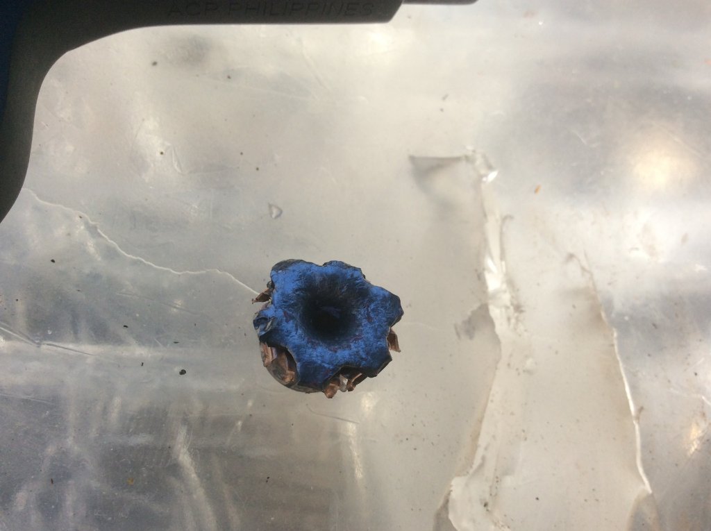

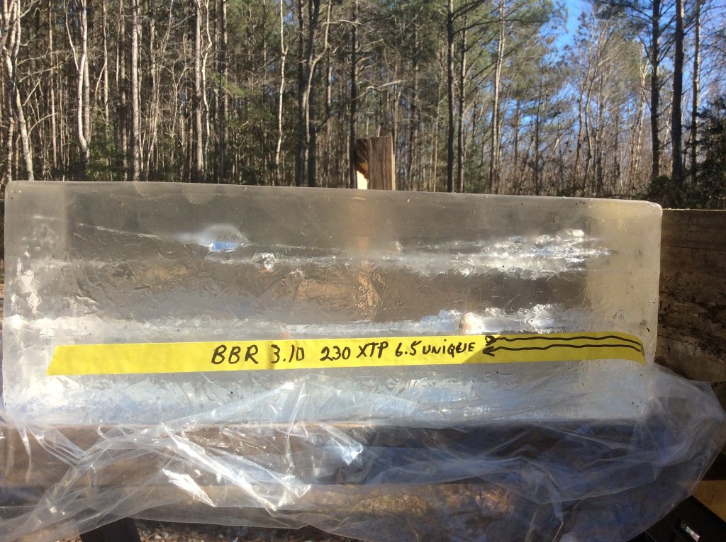

I also wanted to test penetration in the ballistic gel with the XTP bullet since the barrel being a bit shorter than my Springfield XDE and the porting can slow down optimum bullet speed. That test revealed that with a bit less expansion at a reduced speed it traveled thru the 16 inch gel block and hit the wood behind and bounced back into the gel block. Looks good to me with that ragged looking bullet!
