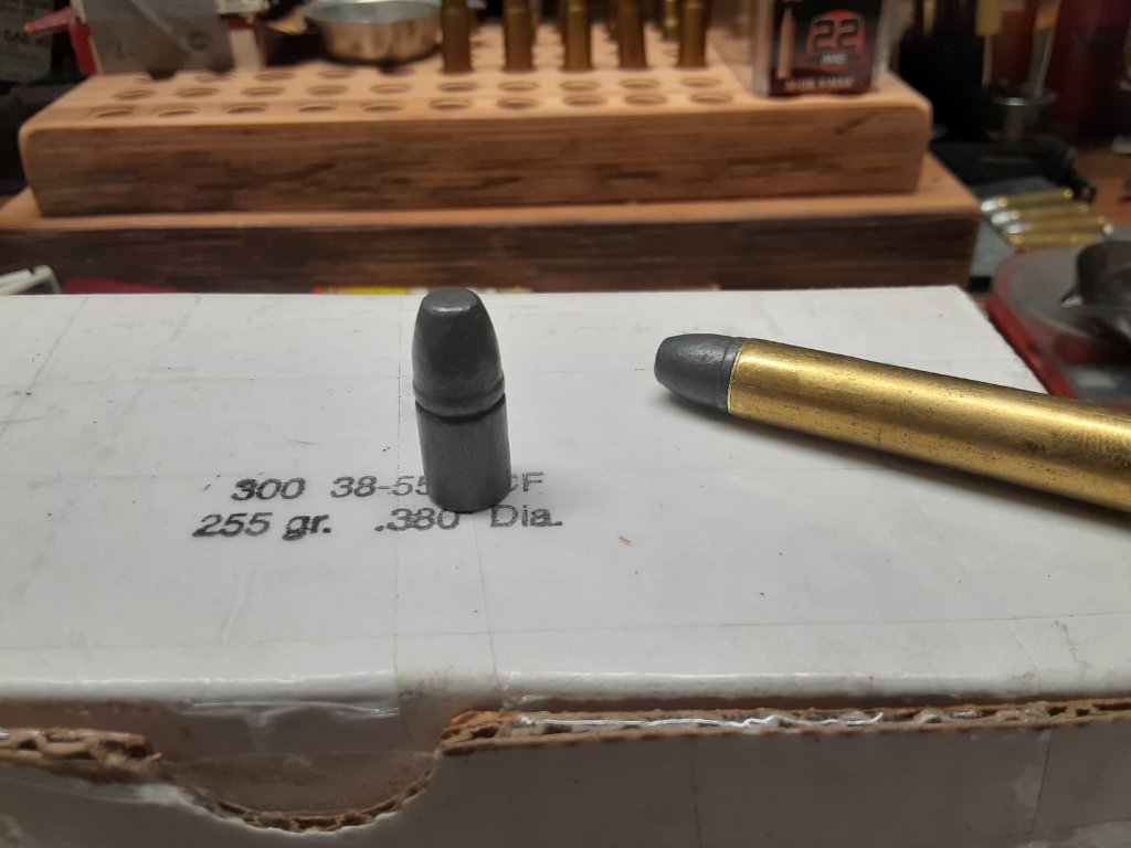

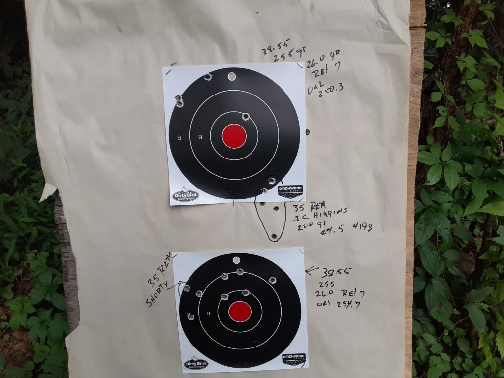

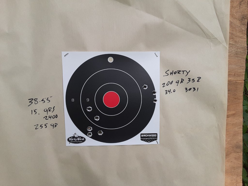

Testing a couple loads in the Cowboy, a 255 gr fn. From Bear Creek Supply.
With rel 7 I tried 2 different seating depths and with the 2400 just stuck with the longer length. They all cycled good, in between I shot a couple 35 Rem.
Each of those I would aim at the lower logos.

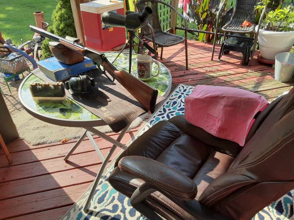

Nice comfy shooting chair Randy! Was the target distance 50 yds ? Interesting in first picture one load went right and the other left.

Thanks Forty, that's the chair that sits at the loading desk. I just wheeled right out the back door.πŸ˜‰ it's only a few feet. πŸ˜…
And yes just 50 yds. back to that dirt pile, have a couple gongs set back there and a target board.

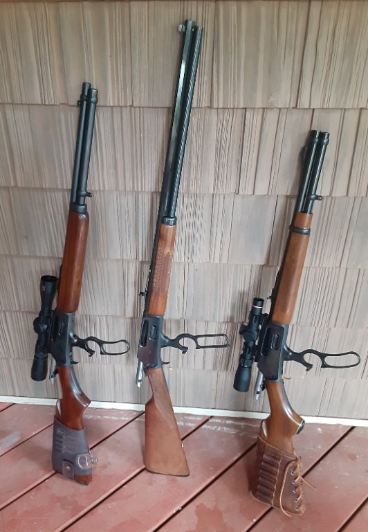

Here's the trio, had a hard time getting it to load, but finally.

Lyman book shows 27.5 max with a 255 jacket bullet. So theres room to play there if you wanna try pushing it a little more.

I may try bumping up a couple grs. or so and see.
26.2 and 26.4 and see what it does.
Going to try some 4198 also, I like it quite a bit and have 6+ lbs of it laying around. πŸ˜‰

Man o man, sure do like the one in the middle. That the CB?
