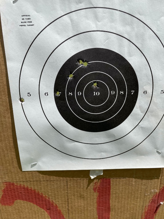

Below is a picture of the first 6 shots double action, off-hand from 15 yds. The shot to the left was my fault and I called it when the shot went off.

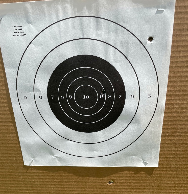

Then I got brave and fired 3 rounds at a target I placed at 50 yds for my rifle. I had to try the 50 yard shot, just for the fun of it. Again I fired off-hand double action. I'm not sure, but that low round, in the cardboard, may have started to tumble and keyholed.
When I fired this load from my Rossi the shots grouped about 6" below point of aim, but none keyholed.

Looks great to me!

Looks good to me Paul.
