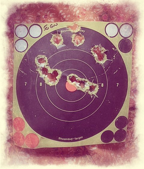

.490 lead ball
.015 pre-lubed patch
50 grains by volume Triple 7
25 yds, off hand
Took a few to get it to start grouping

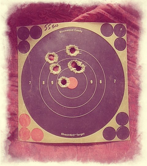

Same as above but 55 grains of T7, noticeable difference in power and recoil, but manageable, and LESS rounds to get on target better I think.

Looks like good shootin to me. For me, if shootin low, I would file front sight down where needed. Then if I wanted a new front sight, I would have an idea of the height of needed to order. I would probably just forget ordering one and be satisfied with the filed down original.

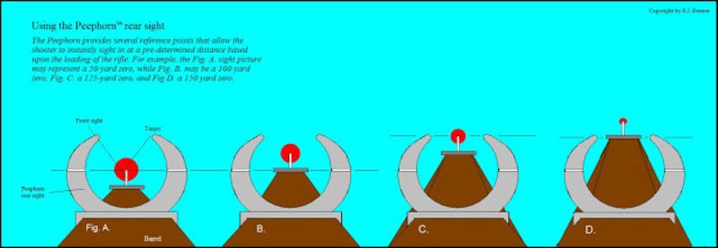

I will wait for the lower front sight to arrive. I think that will get me to where I can use the sight picture to achieve the distances I shoot at. I like this little diagram, it helps me to figure it out. Right now I am using halfway between B & C to shoot 25 yds.
