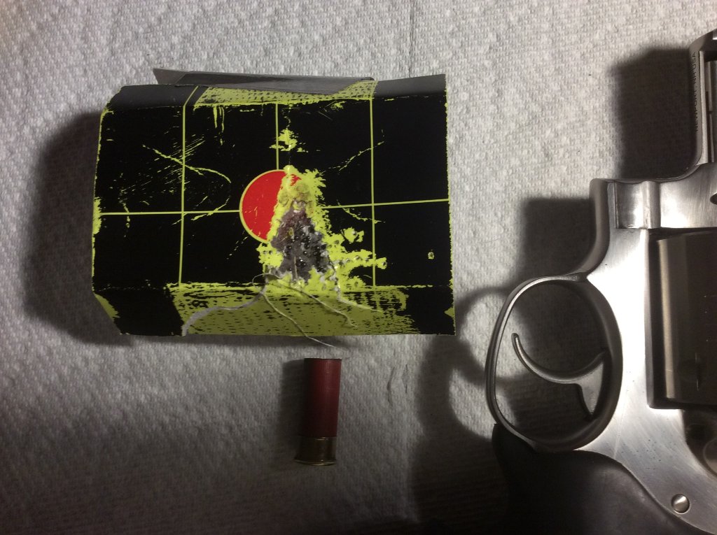

Too cold for the carpenter bees so a range test using ballistic gel with the short .410 load and my Gamo double barrel .22 air shotgun.
Decided to try the .410 load with primer only and 55 gr. of No. 12 lead shot. The original shot cup was used with a cardboard top wad.
Test gun was Ruger Alaskan 2.5 barrel and target distance 7 ft.

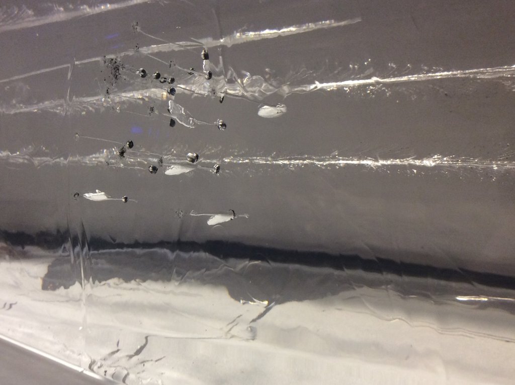

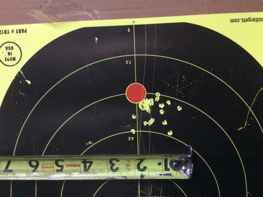

Next was my Deuce 22 the modified Gamo .22 air shotgun. Right barrel used and target distance 8 ft. Load is the factory Gamo shot shell with 17 gr. of No. 9 shot.

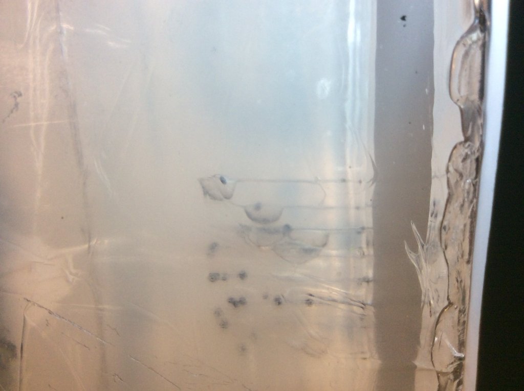

Was a bit surprised at the very tight pattern and with 1/8th to almost 1/4 inch gel penetration with shotgun primer only!
The original load was a download of 3.8 gr. of the .410 powder instead of factory 12 gr. After some thought maybe not best way to go with that type powder and a light shot load so went with primer only.

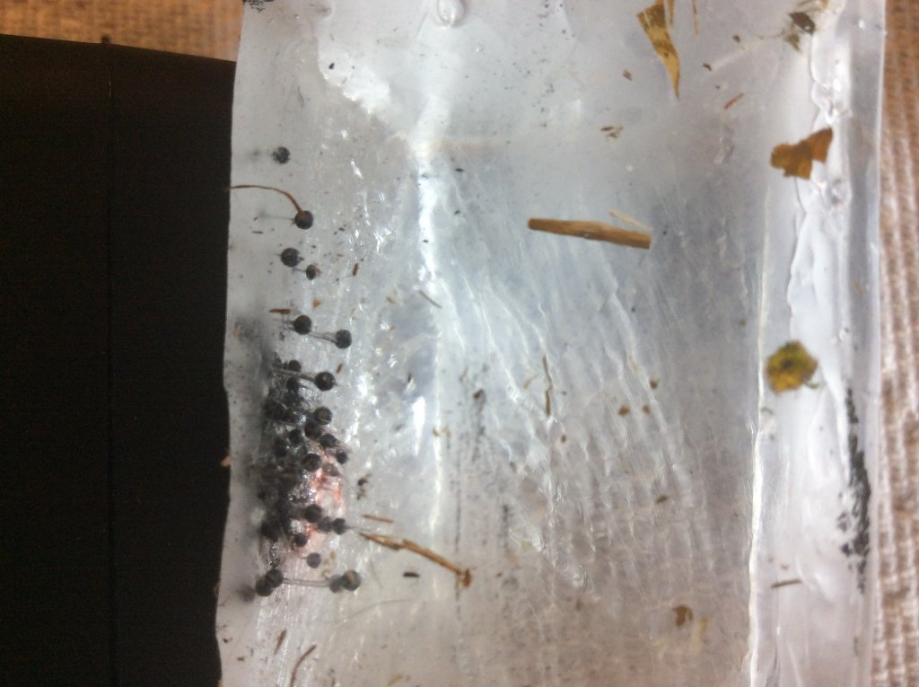

Now that air shotgun has some punch and not a bad pattern on the target. Would definitely take out a flying stinger! About 1 3/4 inch penetration in the gel from 8 ft.
45 shot test No. 12 shot with 410 primer only 7 ft.jpg (138.81 KiB) Viewed 908 times
close up of 12 shot penetration prime only.jpg (99.63 KiB) Viewed 908 times
gamo 22 air shotgun 17 gr of No 9 shot from 8 ft..jpg (134.38 KiB) Viewed 908 times
gamo air shotgun No 9 shot penetration.jpg (71.35 KiB) Viewed 908 times
gamo 22 air shotgun penetration close up 8 ft from target.jpg (95.01 KiB) Viewed 908 times

Not surprised by the penetration of the primer only. I've seen squib 9mm and 45 ACP rounds push a bullet an inch or more into the bore of a pistol. Shotshell primer has more power.
