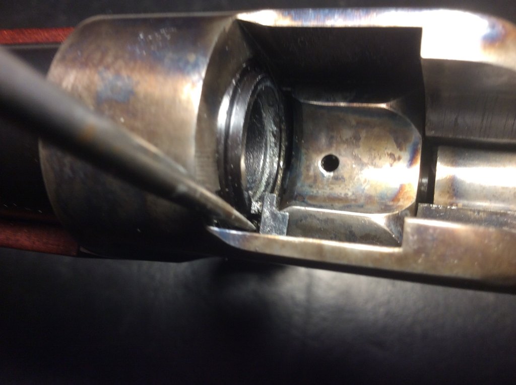

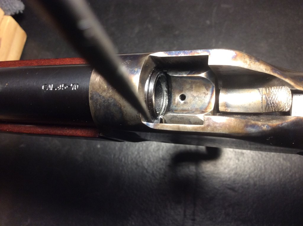

Here is what the ejector looks like on my 45-70 High Wall. First picture is the closed position when round is chambered and last picture when lever is down and case ejected. It appears to work on a linkage tied to the lever and with no spring tension and only moves back about 1/8th inch or so...just enough to break the tapered .45-70 case from the chamber. When the breech block goes down the ejector slides back. You then have to pull it out with your finger.
Now don't know if the ejector on the straight wall case .45 Colt High Wall works the same with same travel? But if it does I can see where there might be an issue with that small amount of travel if the case expands to a tight fit or if blow by build up in chamber tightens up the case.
I don't think at standard Colt .45 load levels there is enough pressure to fully expand case to chamber so it might just be a carbon build up problem in the chamber.
I wonder if a light dry coat of sizing lube on the ammo before loading would help or maybe a spray of dry graphite spray? Give it a try RR!
Note I see in my close up shot I need to do a better cleaning of my case head area of chamber!

Yup. Same design on mine. Carbon for sure. Clean cases pop out no issue.
