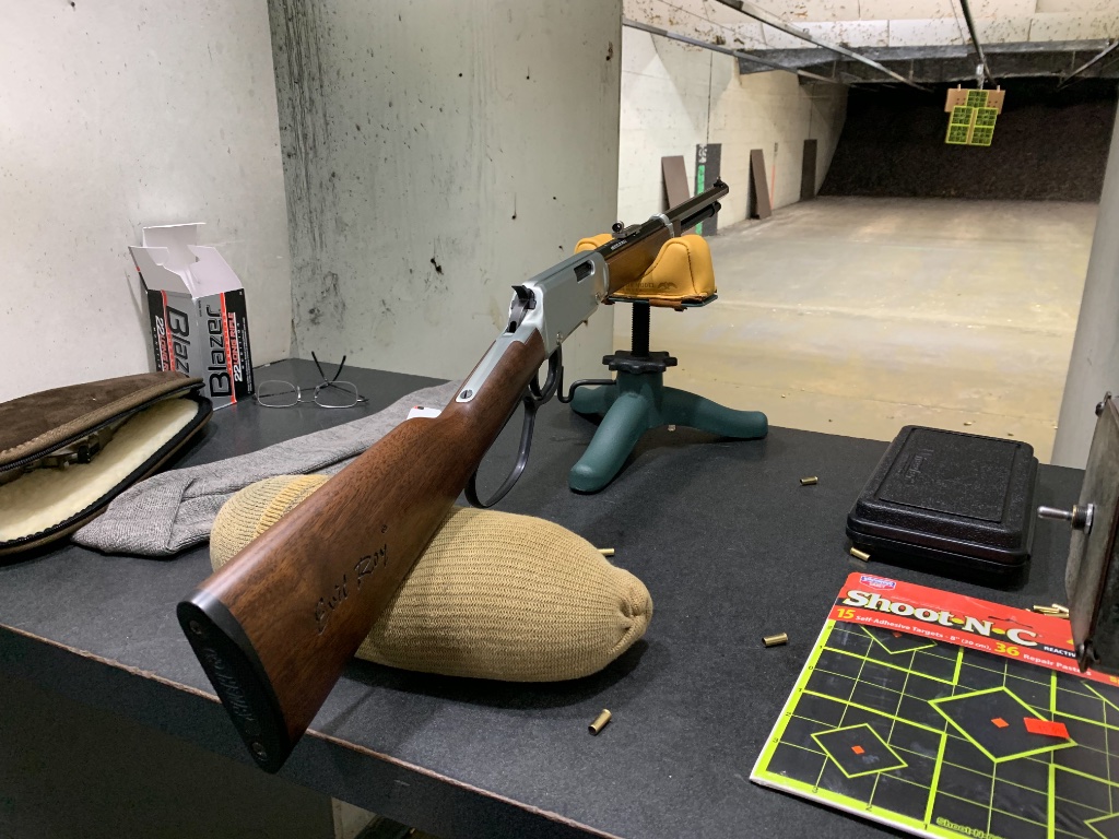

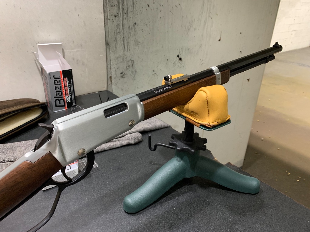

Got a stainless Skinner barrel mount sight for the Evil Roy in the mail today...got it installed and headed to the indoor range to get it sighted in (25 yards). I like the longer sight radius of my SGC better, but this is a YUGE improvement over the buckhorn rear sight. Now I want a smaller bead for the front sight, but I gotta get outside first and maybe I'll be able to see better in natural light.
I need to get some plugs for the holes that were hidden under the stock rear sight too...

Having the Skinner mounted that far forward is almost reminiscent of the Scout Rifle that Jeff Cooper defined/promoted 40 years ago.

I did, but that puts the peep a good bit higher, which would mean a really tall front sight. I had to put a .530" on my SGC, I think the rail mount Skinner would need a .570"...maybe it would work with a .530" also, I don't know for certain.
I didn't know the Evil Roy had drilled/tapped holes farther back on the barrel, I would have gone with the screw on mount for the barrel (hind sight being what it is) even though they are almost double the price...for the longer sight radius. I'm still happy with the way I went on this one.

Were you able to keep the stock front sights on your SGC? Mine shot 3.5-4" high at 25 yards with the rear sight bottomed out.

Raising the rear sight makes it shoot higher.

Always remember - FORS
Front Opposite
Rear Same
With regard to the POI you want the bullet to go when adjusting sights.
