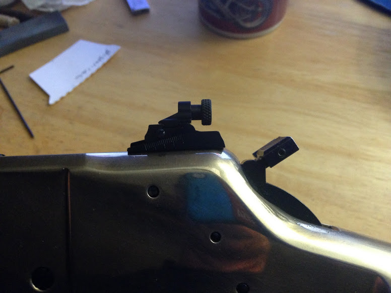

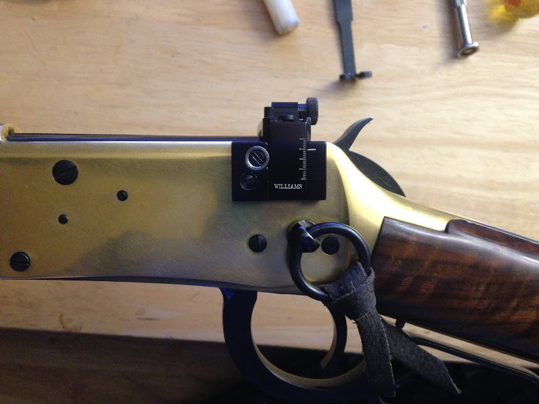

Do you have more information on the Williams sight you mentioned ?
I have three of the standard Williams 94/36s on three of my rifles and a Williams 336 (intended for the Marlin) on my Henry.
I reversed the windage slide on it so I could mount it in reverse so it would not hang off the rear of the receiver.
Unfortunately Williams does NOT make a sight specific for the Henry (their online catalog lists one for it but it was never put into production - Hmm...) but this is a very satisfactory - and inexpensive way to get a receiver peep sight on it.
The bottom pic is the standard 94/36 on one of my Winchesters.

Did you change out your front sight as well ?
Yes. Knowing the Williams was going to set higher on the receiver I knew I would need a taller front so I took the blade front off of one of my Winchesters that was a .490 height and put it on the Henry. Turns out this was just right and at 50 yards with a 6 O'Clock hold I am dead on with the elevation on the Williams at about the halfway mark.
As it worked out I put the one off the Henry back on the Winchester as the height is not so critical with the 94/36 sight due to the greater range of elevation adjustment and like the Henry this worked out well also.
Unfortunately (or fortunately depending on point of view) I seem to shoot the Henry better with the squared off blade style front as it gives me a 'flat' surface to set the target on. The bead being rounded takes me a bit more time to settle in before touching off but I can work with it as well.
If you look at the pic of the Winchester you can see the sight is only a 1/4 of its elevation adjustment up and this again is at 50 yards with a 6' O'clock hold so I have plenty of adjustment if needed!
