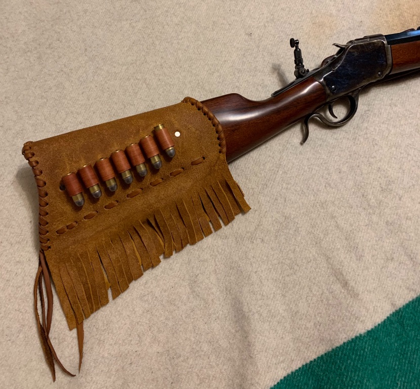

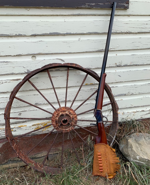

Those are some wall hanger targets for sure, RR. Very impressive for both the rifle and the shooter. Looks like you and that rifle are a perfect match.
Hey, I haven't seen a pic of the rifle, yet. Tang, as in tang peep, right? If so, having that peep close to your eye via a tang mount or a competition target peep is the best way to access the potential sharpening effect that a peep sight offers. Also ranks high on the traditional cool factor for me.
Re: Oct 31st 1885
Post by RanchRoper » Sun Nov 01, 2020 10:34 am
Here ya go
Re: Oct 31st 1885
Post by RanchRoper » Sun Nov 01, 2020 10:36 am
I left the buckhorn sight on too. Gives me options.
