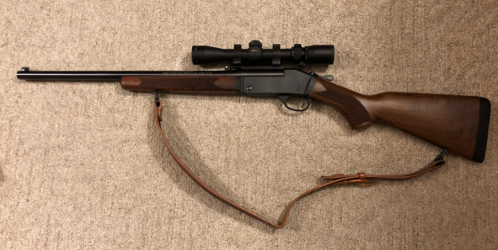

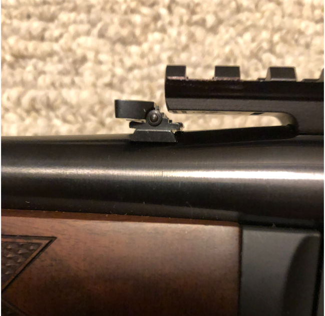

Well I got a rail for the top of the .357. Picked it up at the local shop. The label said it fit Henry Single Shot and Single Shot Shotgun. Well - not so much. So out comes the dremmel. Needed to cut two slots back from the end to get it short enough to get behind the folded down rear site. Then get different rings from the "old ring collection". Got a set that juuuuust allowed clearance for the hammer with an extension on it. Tossed on the Nikon 2X7 shotgun scope. Then Boresight it - the old fashioned way - rifle on bags, open looking down the barrel and adjusting the scope to get it what I think will be "on paper". Took the sling off the 17 HMR too. Now - load up about 20 rounds of 15 grains 2400 under 158 grain XTP's and we'll take a look. For now - here's a couple of pics with her all dressed up....

Looks Good. Keep us post on your load progress

Looks good Zara, waiting on range report. Good luck.
