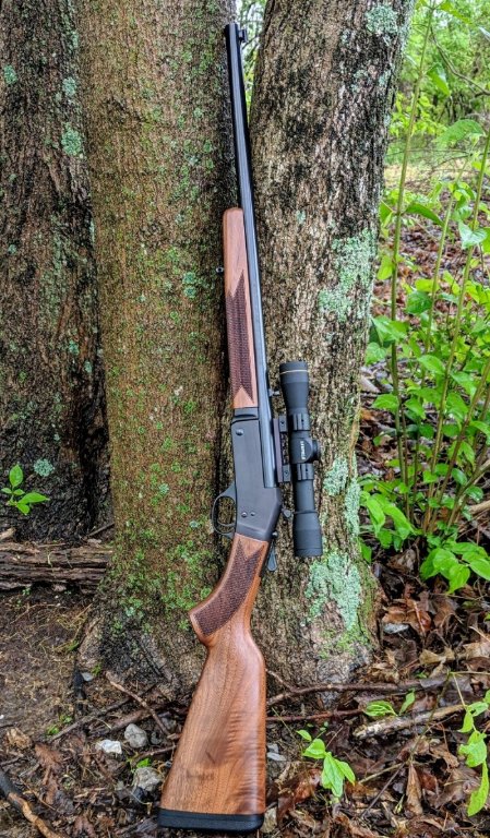

Friday was rainy & windy in northern Kentucky, but I had the day off & was chomping at the bit to work up a good hand load for my Henry single shot.
IMG_20190426_111539 - Edited.jpg (156.88 KiB) Viewed 1537 times
Scope is a Leupold FX-1 4x, low Leupold rings on the Henry rail. Just enough height for hammer clearance, while still providing a good cheek weld. Removed the unused front portion of the rail, so was able to keep the factory buckhorn in place. Looking pretty good, I think.
