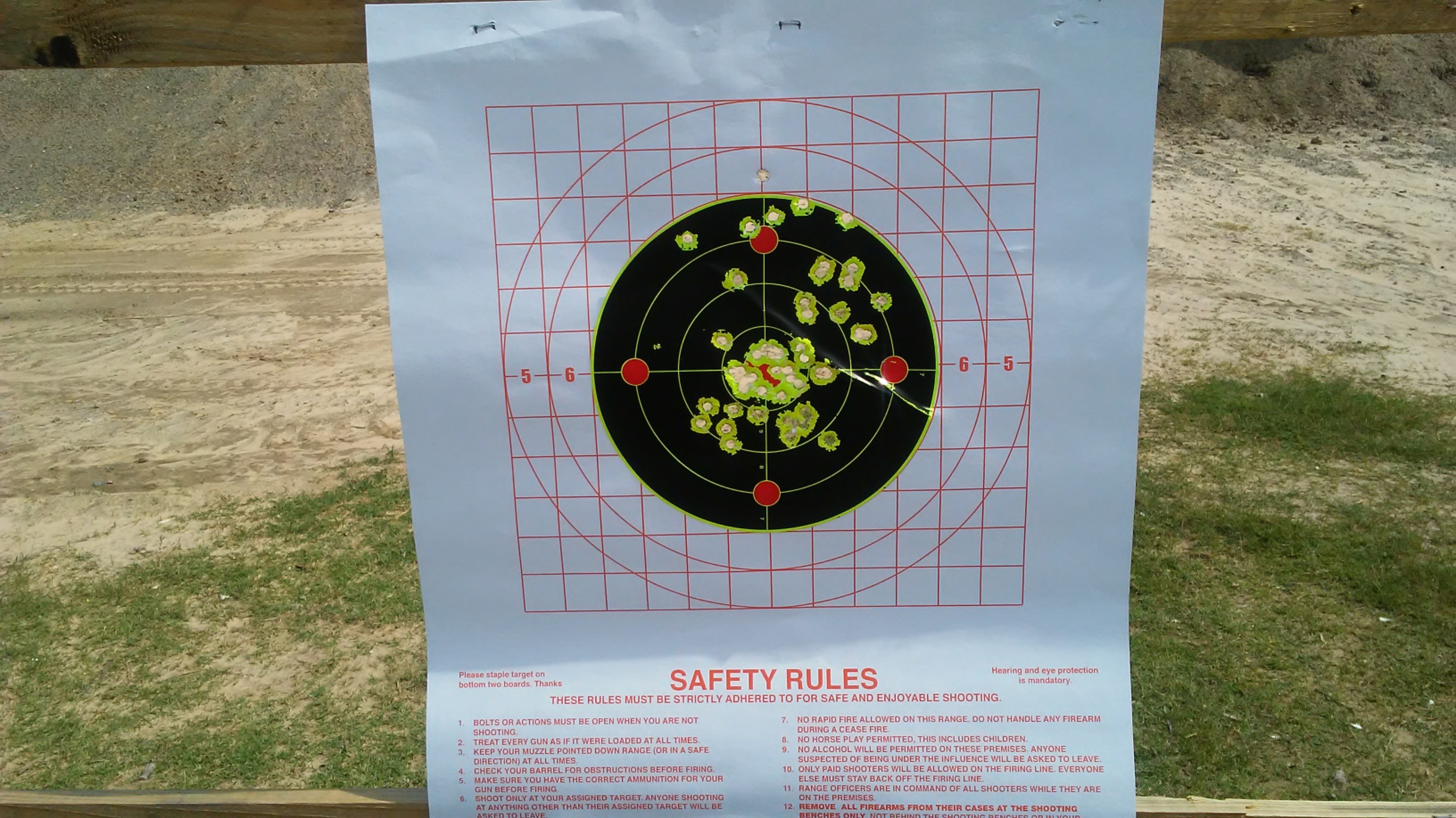

Went to the range today and well, I can't say it was too good. I've decided to send the Henry back for warranty service. The first issue I pondered with was headspace and after discussing some first fired cases with some other fellows at the range today it was a unanimous decision there was a headspace issue. Secondly, I had 5 rounds in a row not fire when I pulled the trigger. I cycled them back through one at a time by hand and they all fired but one. Got pissed and threw the one that didn't fire the second time in the "dud" bucket they keep by the benches. Anyway, I just filled out the warranty request form so hopefully it won't take them too long to respond after the holiday. I tell you it's an accurate rifle and looks great but the mechanics have me doubting if I'll ever get another Henry. Anyway, I'm sure my frustration had something to do with my accuracy today. The first few shots are the ones that are high and the second ones low. I finally resigned myself not to let it get to me and started shooting a bit better: 55 shots/100 yards/unusually low wind today for out there.

Some of those look pretty dialed in to me. I am not familiar with the "headspace" term, sorry about your frustration with the rifle. Hope it gets better.

agree with RR, your target looks good to me

Rounds not firing, I can understand the frustration. Other than that, looks like some nice shooting.
