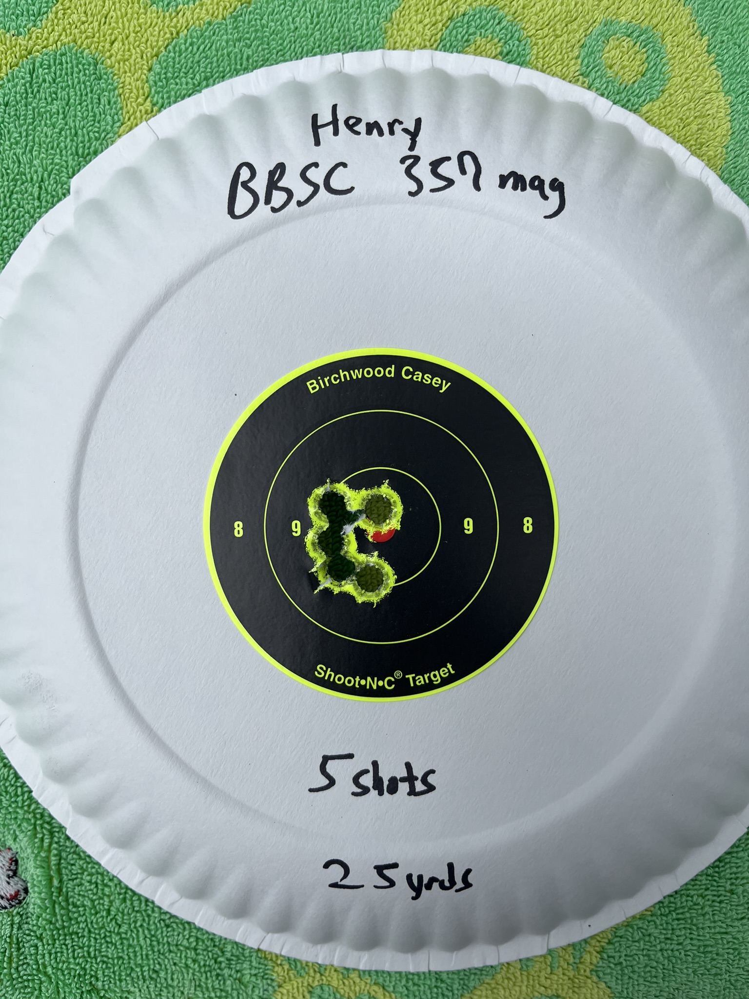

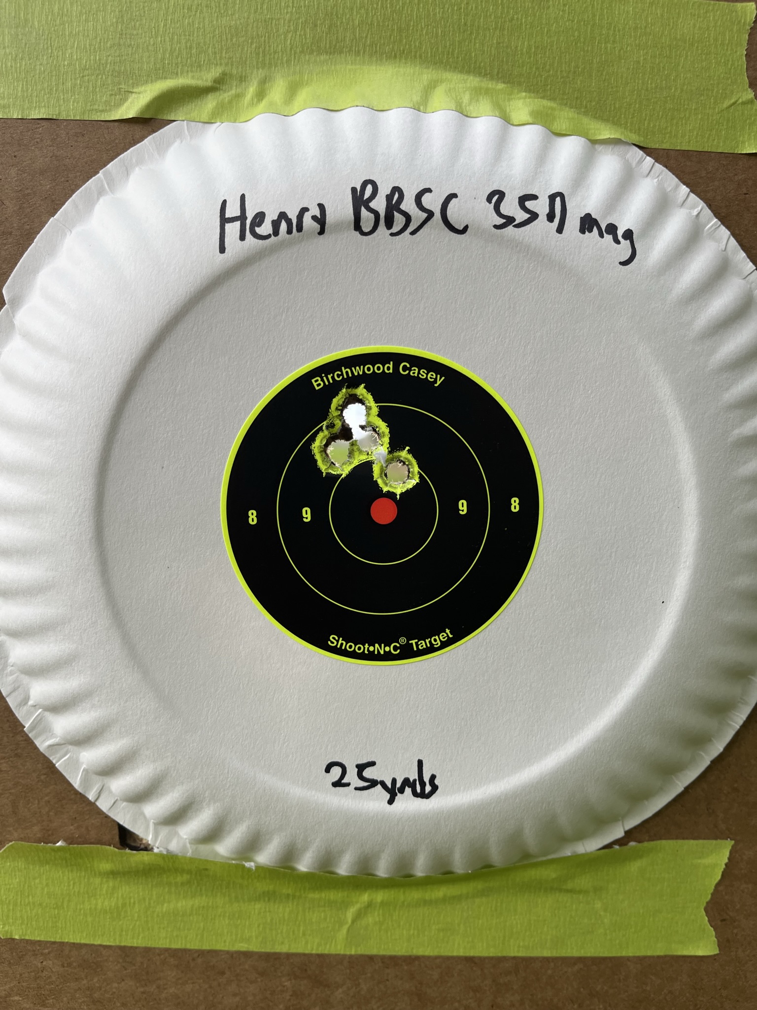

A few months ago I started reloading .357 magnum for my BBSC. I wanted to keep things as simple and inexpensive as I could. Although NOT inexpensive, I settled on using Hornady’s 158gr XTP bullet. I found a local supplier that stocks Alliant 2400 powder and lucked into finding 1500 small magnum pistol primers at Academy Sports. I had about 1600 pieces of once fired brass (from my own rifle). I decided to purchase the Lee Precision hand press and 4 die set as well as a Franklin Armory powder scale. After experimenting with the different power levels I settled on 13.3gr of 2400 as the most accurate from my rifle.
Over the last couple of days I have gone to the range and shot some groups at 25 yards and 50 yards. I prop my rifle on my range bag as I don’t have a proper rifle rest. I’ve got a Skinner receiver mounted peep sight and a patridge front sight (with orange paint) on my Henry.
Here are my best 25 yard groups:

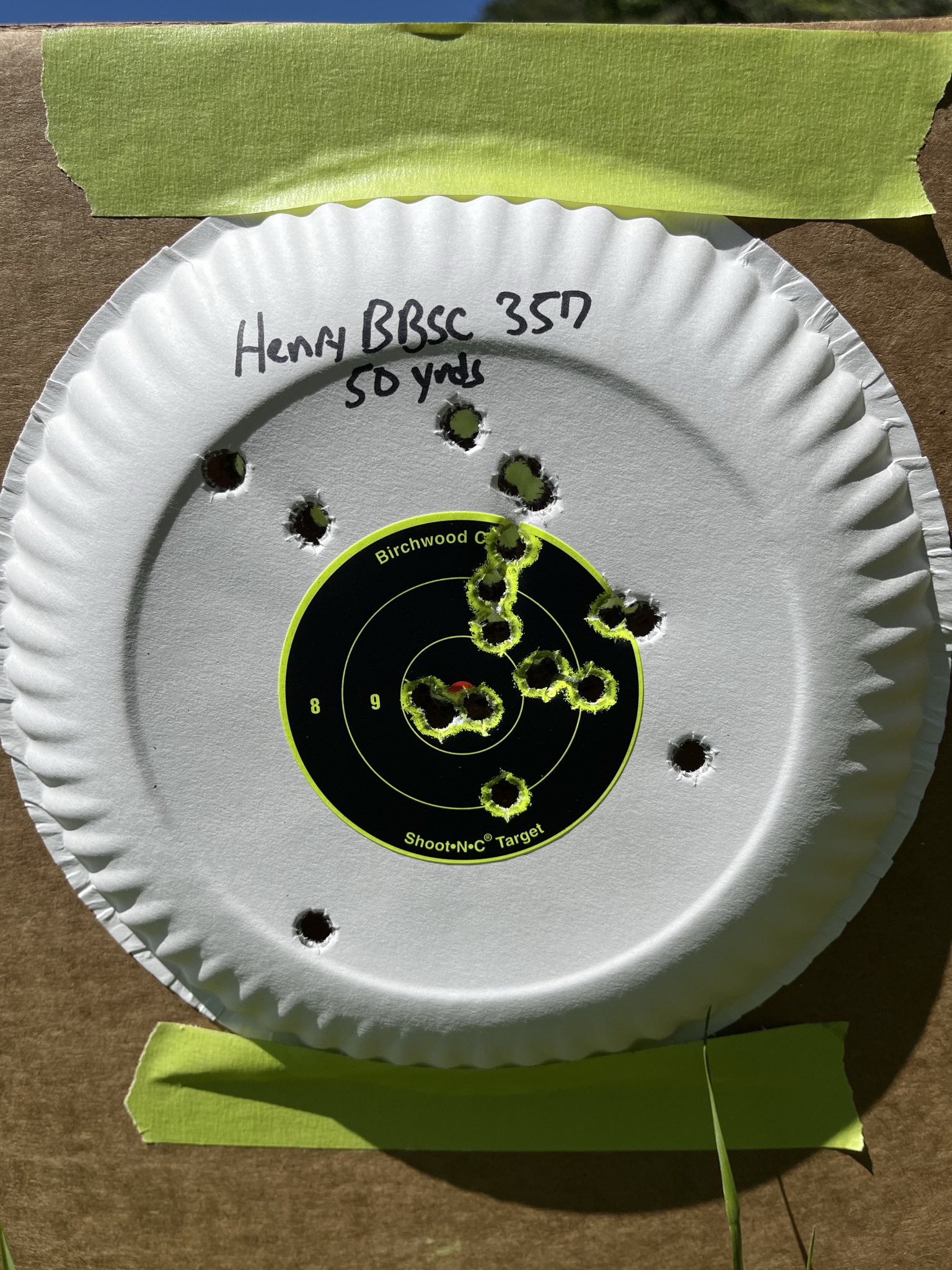

These are 11/16” groups which I am VERY pleased with! I stretched it out to 50 yards and ended up with this:
At 50 yards, the front sight nearly covers the entire plate. It’s very difficult to find a consistent point of aim (especially with my vision getting poorer) but I am quite satisfied with the results. I feel like I’ve found an accurate load. Hope you guys enjoy the report.

You cannot beat 2400 in 357. I push mine to 15 with the same bullet. It will put some nice groups up there and is a great hunting load. Congrats nice shooting

Agree with Al, 2400 is a very good .357 powder. Your groups look fine. Will you be using the XTP's only, or venturing into cast type bullets?

Nice shooting on all the targets shown above. Those Henry 357’s just shoot!
