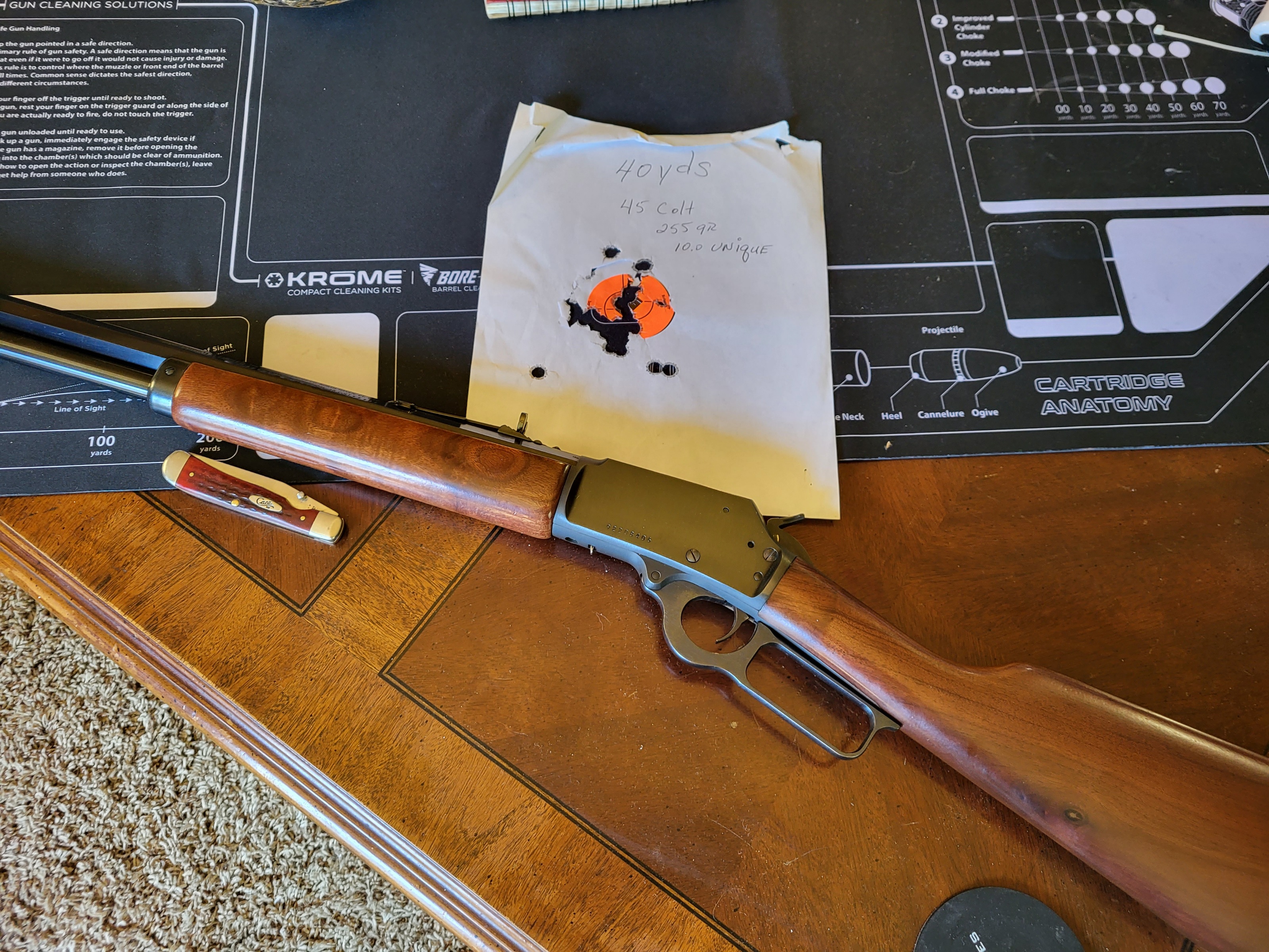

Post by Vaquero » Sat Apr 01, 2023 11:56 am
Hey Tom, I think it was you who said something a while back when I was loading these.
I believe this dog will hunt. ;) :lol:
Will see if I can mange a couple hits on the 140 yd gong. :roll: :lol:

Post by Rifletom » Sat Apr 01, 2023 1:09 pm
Was I polite? :lol: Seems like a handful, but, probably fine in the rifle. Shoots good. How'd they feel?

Post by fortyshooter » Sat Apr 01, 2023 1:16 pm
Yep that is a good load right there and about max for using Unique. From there 2400 for the rifle up to a max Ruger load.

:lol: yes sir. You know you're shooting something, but it's not bad.

Post by 5shot » Sat Apr 01, 2023 10:02 pm
Good shooting! Out of the BBS I've chrono'ed 8.2 of Unique with cast 255's and got 1135 fps. and 9.3 of Unique under a 250 gr. XTP averaged just under 1200 fps. I'd guess you're in the mid 1300's with 10 grains of Unique and a 255 gr.

I don't know as I don't own a chrony. :o
I've never been a speed demon when it comes to reloading, I'm just looking for accuracy.

Post by Mike_S » Wed Apr 05, 2023 7:20 am
That's a good looking knife! :D
Case?

Yes. And thanks
