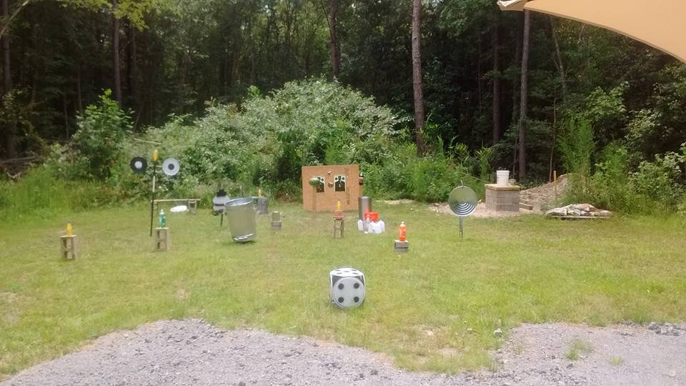

Post by fortyshooter » Tue Jan 19, 2021 7:45 pm
Here is another target area on my range that was a large pile of timber from clearing the area and is grown up with weeds.
I like to use that area for shotgun targets or close in steel targets. That old sand box I mentioned before is behind the target board with the two paper targets. And don't shoot the white bucket to the right....hand pump for well under it! :lol:
other target area.jpg (104.76 KiB) Viewed 1283 times
