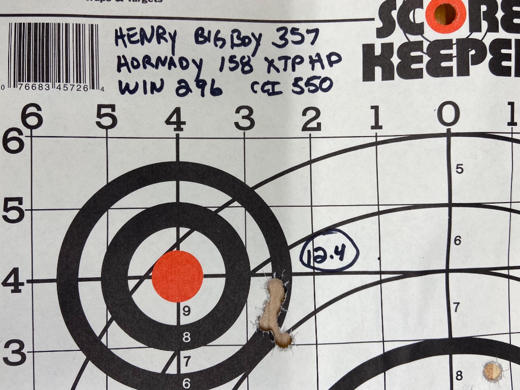

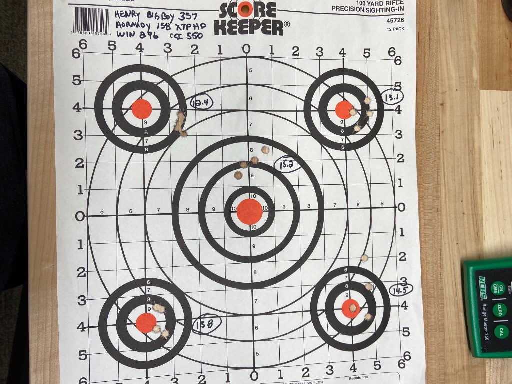

Yesterday I ran my laddered loads through my BBS 357 and found the sweet spot.
Hornady 358 158 XTP-HP
Win. 296
CCI. 550 sm pistol mag
Four shot groups
50 yards bagged from a bench. Calm winds 40 degrees.
Here’s my results with the five loads I tried. While none of the groups are terrible, well maybe one is, the lightest load grouped the best. All four shots touching.
I have about 150 cases prepped waiting for the charge results so I’m gonna get to-it. :D

Nice shooting Hatch. Ive never cared for 296 or 110. Ive always used 2400. But looks like you have that one dialed in with it.

12.4 g sure produced a nice 50 yard string 8-)

Looks good Hatch! Depending on what use the 12.4 is fantastic with just a windage adjustment. If you want more thump at 50yds. the 13.8 is a great mix of group and power.

Before I shot these loads I shot some factory 158 that I had used to sight in the BBS. I wanted to make sure I was on paper before shooting my laddered loads as I didn’t load any extras. I was happy my loads hit within reason and will fine tune the zero when I get more loaded. Always great to have a “need” to go to the range. :lol:
