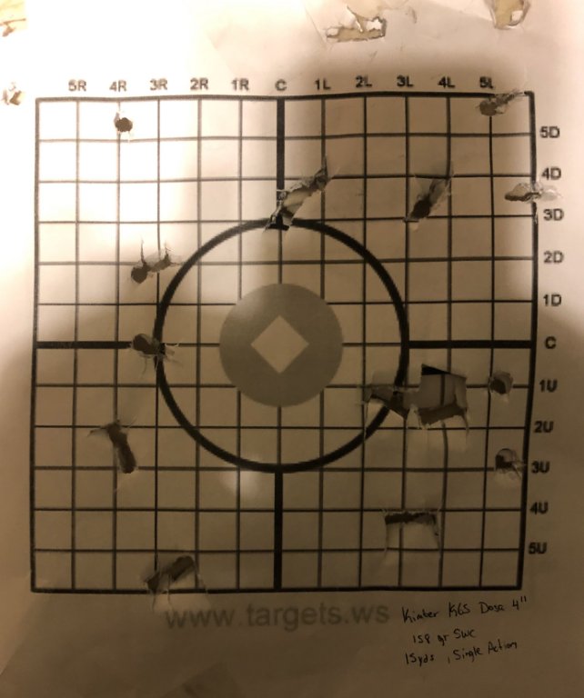

Post by JayZuv » Mon Sep 28, 2020 11:51 pm
Got the new revolver out today for the first time, starting off easy to get the hang of it. Shot at 15 yards, standing. This was my second grouping after making a few sight adjustments. It is a blast to shoot, and with the .38 specials you could plink away all day without a sore hand (or wallet). These were factory PPU loads with a 158gn swc, the only thing I could get my hands on. They were fairly accurate, but did NASTY things to my shiny new bore. Will detail that in a seperate post. Overall, really liking this little revolver. As soon as my bullet order shows up, I will be working up some loads and sharing results on those. Cheers!

Post by fortyshooter » Tue Sep 29, 2020 8:24 am
Interesting bullet holes. Was there a cardboard backing behind the target? Looks like a few keyhole hits.
Not bad for first shots with a new revolver! Maybe if you can find some jacketed ammo to try next time out.

Post by JayZuv » Tue Sep 29, 2020 8:53 am
There was a backing behind it, but the paper was loose and hanging away from the cardboard. I noticed the strange bullet holes also. It is possible the way those bullets gummed up the barrel however.
