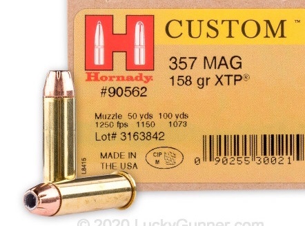

Try some ammo with a round nose profile AND no exposed soft lead. The lead can deform and also hang up. Some Hornady XTPs would be a good test, they are affordable, or any full metal jacket range ammo. Have you tried snap caps? I like the A-Zoom ones.
My .44 Mag X had to go back because it would not feed ANY ammo at all, nor snap caps. It works fine now.
