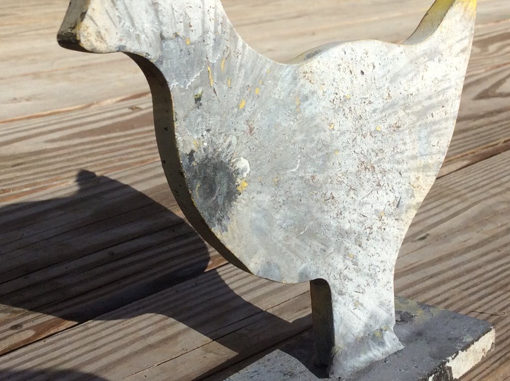

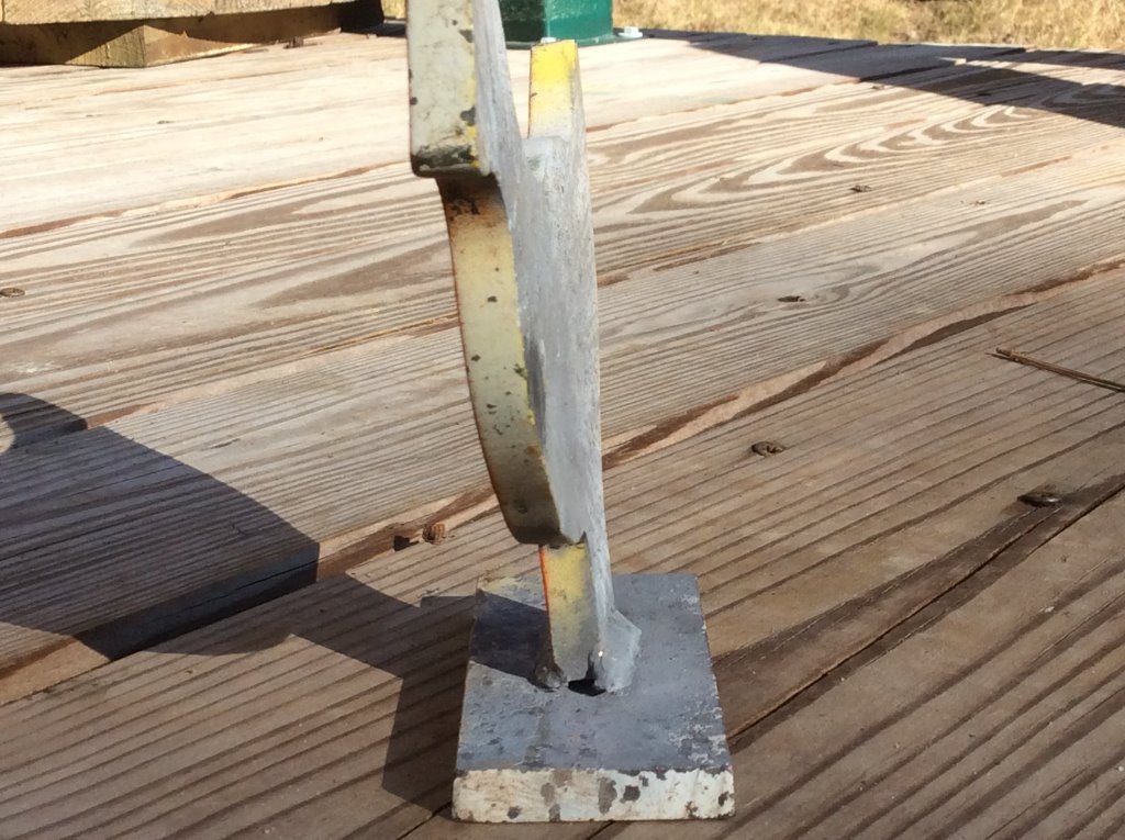

:lol: Yes all it took was a hard breast hit with the Henry .44 Mag and it sent that little chick flying breaking loose a not so penetrating weld!
Had to take it home to my target hospital for a mend!
hard .44 mag hit.jpg (153.54 KiB) Viewed 2970 times
little chick took a hit.jpg (161.29 KiB) Viewed 2972 times

That is a lot of torque that bullet put to that target. The way it was bent and the weld break.
Looks like a Hunter Pistol NRA size usually at 40 meters I think.

When shooting that little chick from 20-25 yds. lucky to hit it someplace!
That was a good looking but cold weld. Heat setting wasn't high enough to penetrate to foot. That was the factory weld on AR500 steel.
Now I make my target feet out of thinner mild steel and they seem to hold up better like on the big coyote.
