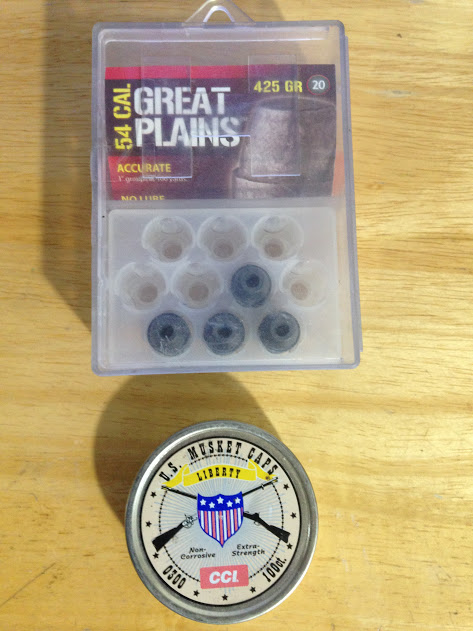

The Hornady 'Great Plains' bullets are the best hollow base conicals for it and are incredibly accurate in both of my rifles. Your '64 should be a .58 cal and the ones in the pic are .54 for my Renegade but the same bullet.

The info about the bullets and the powder is very much appreciated. I'll likely follow your advice on them, but are you referring to CCI 0301 four wing caps?
https://www.cabelas.com/product/Four-Wi ... s?slotId=0
They've gotten some bad reviews (and not just at Cabela's website), so I'd like to learn more about them.
Edit: I see in your photo the caps you use are 0300, not 0301. I'm guessing there's a big difference.
Probably not as much as you might think.
The CCI's in the pic I posted are six wing style and will be fine. There are also musket caps with no wings - go figure.
I looked up the 3001s and it states they have a lighter charge and are intended for reenactment use which would mean powder & wad only for noise.
I suspect some have used them to actually shoot with and probably got weak or inconsistent ignition.
