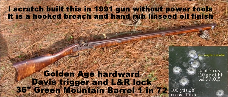

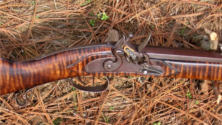

I got my Buck the 1st day with my 50 cal flint gun shooting a patched round ball at 75 yds he dropped like a rock . All inline and scoped BP guns should only be allow in reg rifle season and leave ML season to real Muzzle loader . The same thing with scope cross bow should not be allow in archery season . I got my 1st ever Buck with a 60 lbs Bear recurve bow and I shot wooden arrows too and NO SCOPE .
Hack
Re: BP rifle for my husband~~~
That is a gorgeous rifle.
Taking a buck with a flintlock is an accomplishment, given the delay and the reliability issues.
