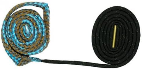

As I posted early I got a new rifle. The X model in 357.. The h012cx.
I bought a bore snake for it. This was my first bore snake, as I have always used the cleaning rod routine. Have had guns since I was 16.. I was doing the new gun cleaning routine.
I started with the snake and then I thought it got stuck. talk about an "oh no" moment. Did I get the wrong size or what.
So this is the hoppes viper. It has a pull handle attachment. I tried to pull it back out the breech. No movement.
Wrapped the string part around the handle until there was no lead left and tugged. It came along and out.
I was relieved.
The videos I have seen with a bore snake seem to me it did not take that much force.
Just goes to show there is no replacement for the actual process of doing things. :oops:

It get easier and easier to use with use.

I love bore snakes. I have both Hoppes and Otis. They seem like the don't want to go through but elastic enough that they'll make it. Don't give up on them too soon!

They are a bit tight at first, but if they were not, they wouldn't be doing much good.

I really like bore snakes for a quick clean and for rifles with difficult to remove bolts like the Mini 14 and M1A. Fortunately our Henry’s bolts are easy to remove for a good cleaning with a rod/brush/patch. My snakes don’t have a handle but I find that after pulling it far enough from the barrel to expose some I have to wrap it around my palm to pull it out. I’m good with that as I know it’s doing it’s job.
My 357 snake is a handgun length but it’s fine for the 20” Big Boy barrel. I always feed it thru the receiver and out the muzzle.

I agree with the use of the boar snake. Yes, it is difficult to pull through. But, I believe that means it is doing the job it was intended to do. I have never seen any residue after using my bore snake. If I ever do, I will move to the brush and patch and rod system.

A bore snake won’t remove copper fouling but will do a nice job cleaning powder residue and other contaminates in the bore. Every now and then it’s a good idea to run a copper remover such as Eliminator. I shoot local F Class matches where we shoot 88 shots and find that I get considerable copper fouling doing so. Running a solvent such as Eliminator will cause the patches to turn green as they pick up the fouling. I keep brushing (nylon) and running patches until the green no longer appears. This can take awhile and doing a solvent soak a couple of times helps.

Jerry, I had the same experience with my first boresnake, which was just last year. I thought it was stuck, but, stubborn as I am, I pulled hard & it came on thru. Like you, I found out that was the nature of the beast. All's well.

Pay special attention when you buy a bore snake. Some say pistol and some say rifle in the same caliber designations. I have learned not to use a pistol snake in a rifle, even though the pull string is long enough on a lever action rifle. I had the pull sting break once and I can tell you that you don't want that to happen. I really believe the pistol snakes are slightly larger than a rifle snake of the same caliber - maybe because on a revolver the cylinder chambers are slightly larger than the bore.
That is my experience - never use a pistol snake in a rifle. Never had a problem using a rifle snake in a revolver.

Here is what I have for my Henry Big Boy 45LC. Works great.
Ultimate Rifle Build Barrel Snake - https://www.amazon.com/dp/B06XBS6MWF/re ... 6N1S?psc=1

Wish I had invented those suckers! :D
They are very easy to use, and work very well.

IMO they are not a substitute for a rod and brush and jag. I thought they were the greatest thing since sliced bread when I got my bolt action Savage and started using it all the time. After a while, I started noticing my accuracy was dropping off rather drastically. I tried cleaning the barrel with a brush and got long pieces of copper out of it. I gave it a very thorough cleaning and accuracy went back to normal. I now relegate the bore snake to a quick cleaning in between.
