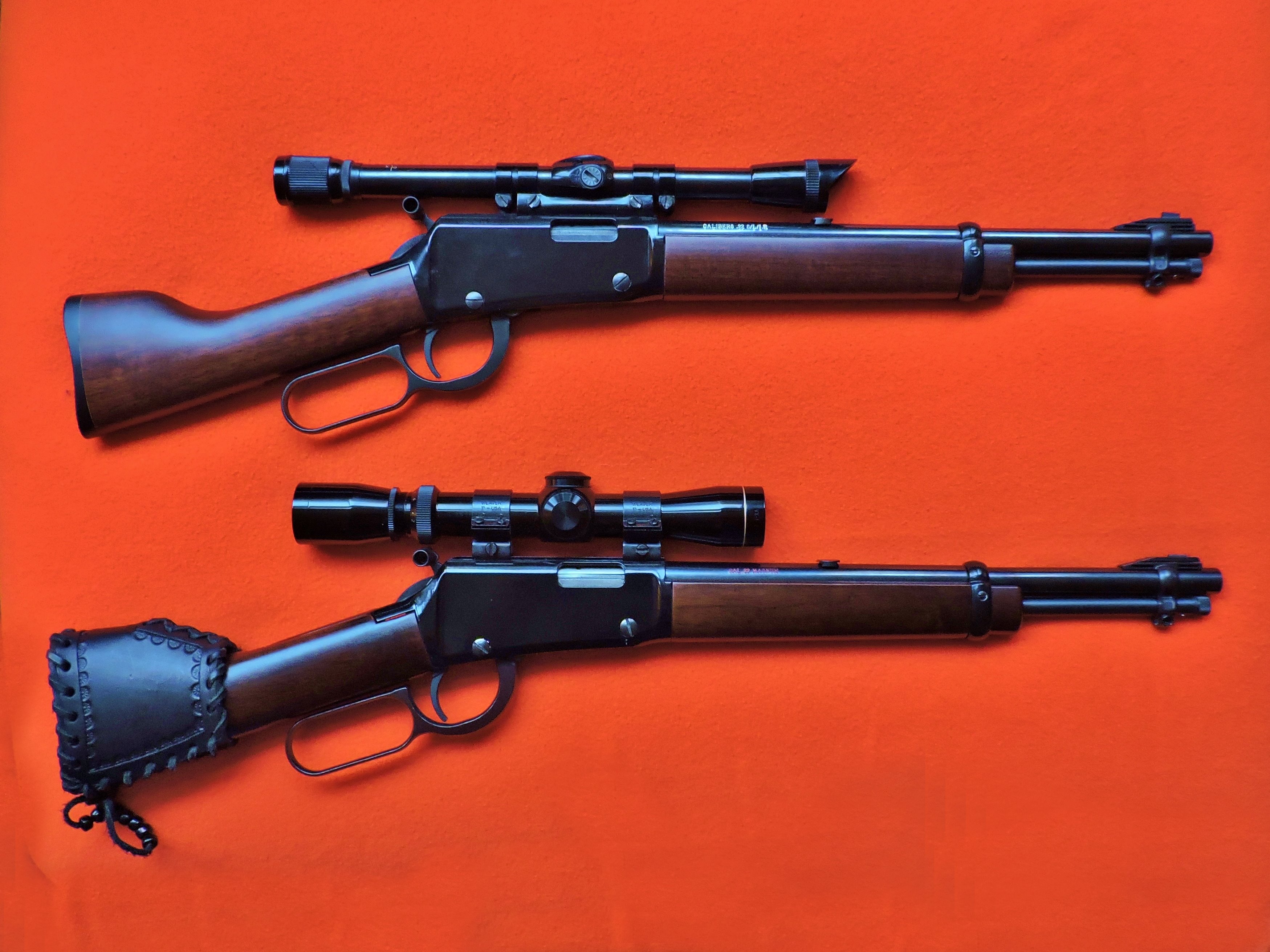

I have one and put a Leupold VX-1 2-7x28mm Rimfire on it. They aren't made anymore but do make it in a 33mm.
https://www.leupold.com/scopes/compact- ... 1-2-7x33mm
The scope sets on vintage Weaver T-USA scope rings. Please note Weaver rings are made both in the USA and China. They both have the same part numbers but the China made rings are much softer. It may take some searching to find the ones made in the USA.

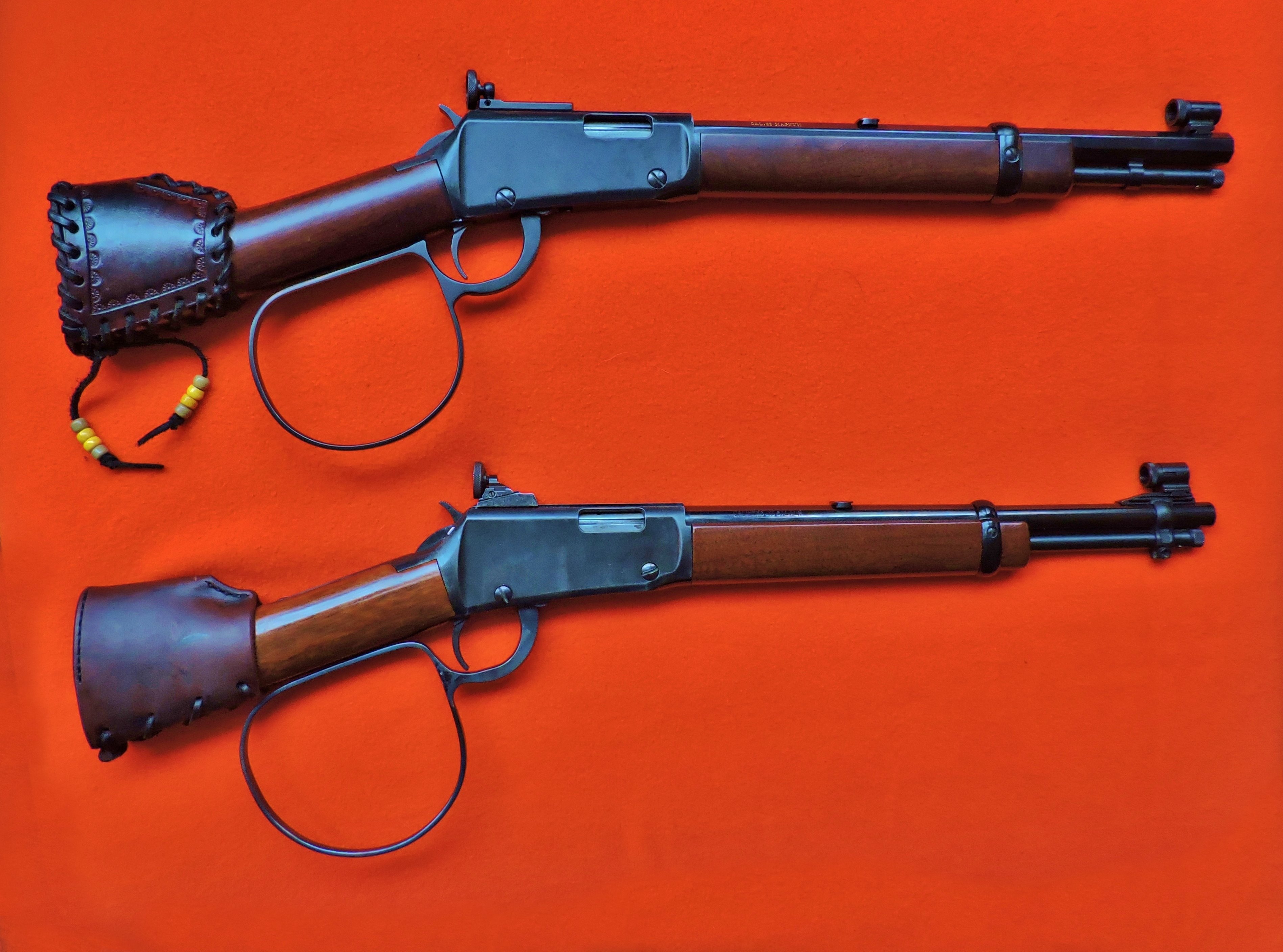

I have four M'sLegs and two are scoped and two have peeps. I moved the peeps to the receiver to give a longer sight radius. The radius is now about where it would be on the Classic.
Out of the four of them I very seldom shoot the scoped ones.

I feel the same way RS. But try a Skinner receiver peep as it will increase the sight radius making it a lot more accurate.
