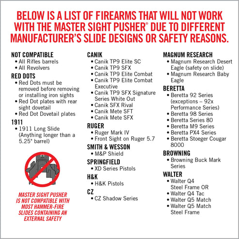

I'll let you know. Probably a week or 2 before it arrives. The Real Avid site (below) has a lot of info about it, including what it won't work on. It's the pusher recommended by Sig Sauer for their pistols, which I have a couple of. There's also a couple of demonstration video's on youtube.
I had a hard time finding one on-line that wasn't $150 and up, but got it ordered thru AAFES (military) for $135. :)
https://realavid.com/products/master-sight-pusher

That's a lot of guns it won't work on. I used it on a Magnum Research 1911 10mm. I took a little fiddling but I made it work without damage. It is a precise well designed tool that worked well for what I needed done. I was not able to move the sight on the 10mm with either of the tools 5shot pictured so I bought the Real Avid and it worked. I was able to adjust the new sights where they needed to be. But, it is expensive and I may never need it again. Have in box if you are interested I am sure we can come to a good price.

Too late. Ordered it yesterday. But maybe someone else would want it if you put in the Classifieds. :)
