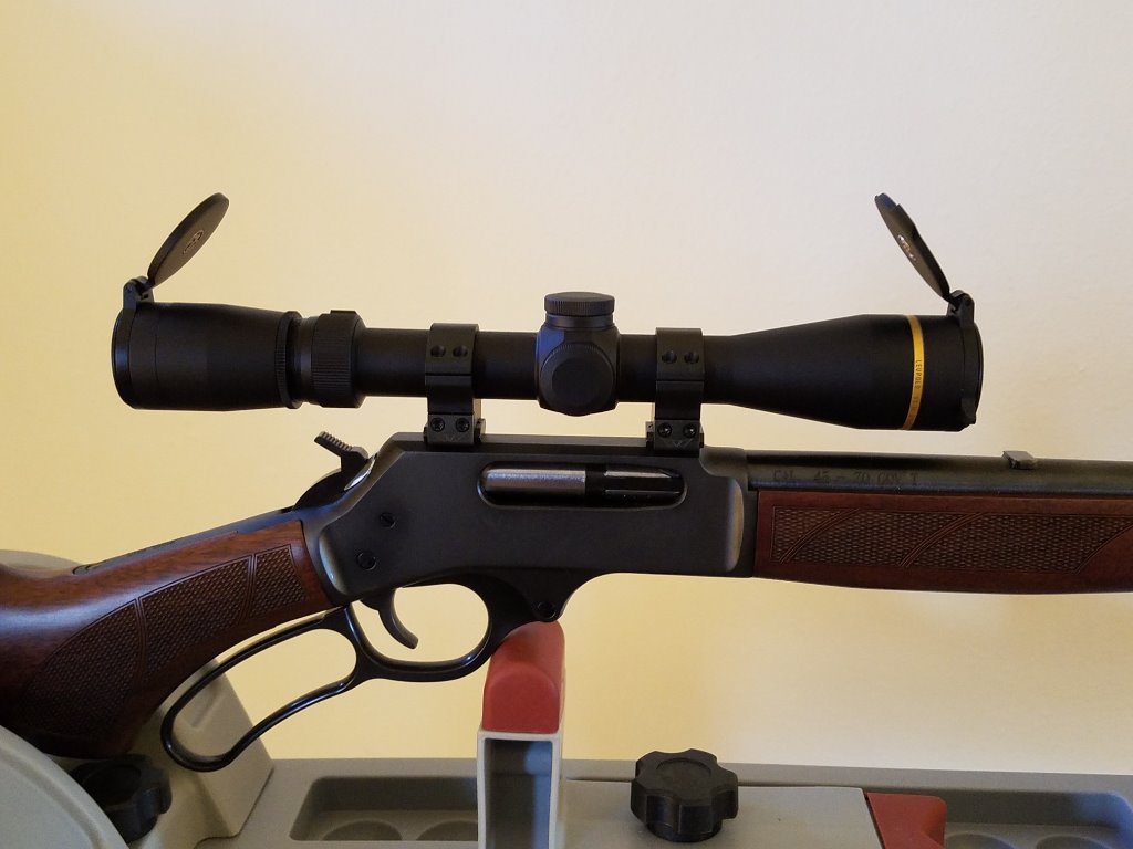

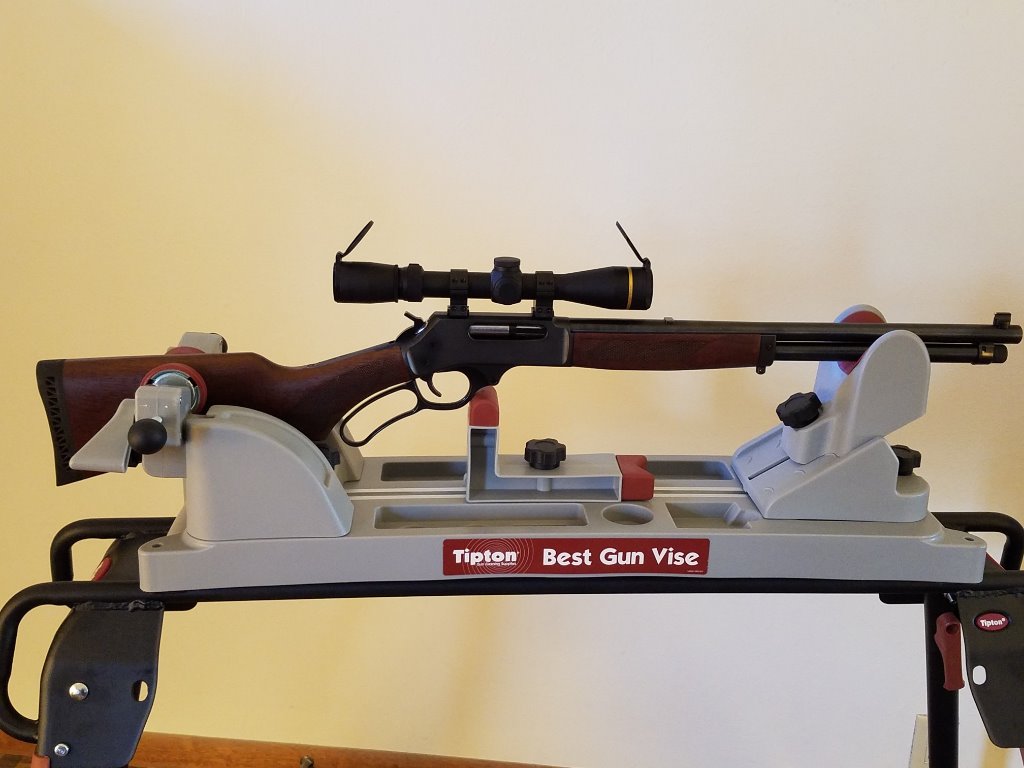

I finally made the time to mate the scope up to my 45-70. The only challenge I had was removing the factory installed receiver screws. Two of them were WOW tight! :o I was glad that I ponied up for Wheeler's gunsmith screwdrivers, they payed for them self today.
The scope is a Leupold VX3i 2.5-8x 36 with the Duplex Reticle and their flip up lens covers. I used Warne's Maxima base and rings; true to their claim, they didn't require lapping. When I checked the alignment, my Wheeler alignment pointers were point to point. I checked the reticle against my Leupold bore sight tool, ten clicks of windage and 8 down clicks had it centered. I'm pretty confident it'll be on paper and I won't have to chase it to find zero. Overall I'm very pleased with how it all came together, using the proper tools made it even more enjoyable. Hope the pictures download ok should anyone else need a reference to what scoping a H010 looks like. :) Hope to get to the range soon.

NICE .... very nice indeed .... looking forward to following your range reports and use impressions

Yes, that came together nicely. I have a similar Leupold on my Henry .45 Colt. Big improvement in my shooting. That does look good.

It looks really good. Nice looking gun vise, too ;) .

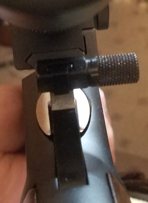

After I installed the scope I realized my thumb was going to have a challenge pulling the hammer back. I checked into a couple of different styles and decided on the Grovtec extension. I ordered it from the Henry Store before it closed for CV-19. It is a very nice fit, I will not have a problem with access to the hammer now. A simple little accessory that makes a big difference ;)
Henry Hammer Extension.jpg (50.68 KiB) Viewed 5380 times
