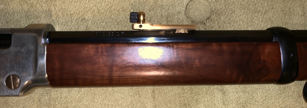

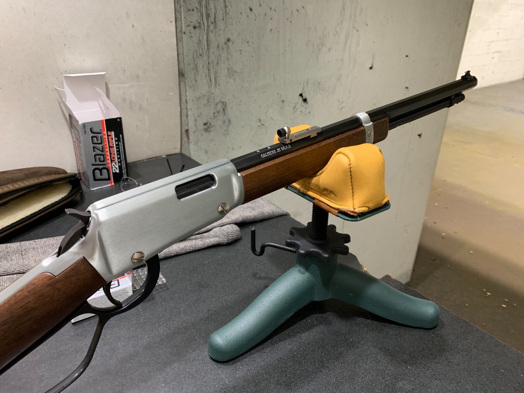

CT_Shooter posted a good option for you, although that Golden Boy Express may also require a taller front sight.
There are two other options you could consider, they are both "barrel mount", one uses the factory drilled and tapped holes on the octagon barrel hidden under the factory dovetail buckhorn sight you have now. The other option is to get a dovetail mount rear peep sight. I put the stainless dovetail mount peep sight in my Evil Roy (picture attached for reference). Knowing what I know now, I would have gotten the barrel mount that uses the factory drilled and tapped holes on the barrel...it gives a slightly longer sight radius. Still not as good as the factory Small Game Carbine I have, when it comes to longer sight radius, but still much better for my crazy eyes than the buckhorn sights.
I also put one of the dovetail mount rear peep sights on my daughter's Golden Boy, her's is an older model and didn't come with a drilled and tapped barrel.
Both of ours with barrel mount peeps worked perfectly to get sighted in and zeroed at 25 yards with the factory front sights.

Woao! There sure looks awsome!
