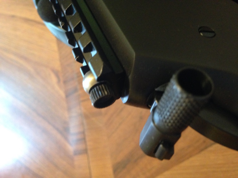

Hey Marvin! I am having trouble posting my discussion on this subject. I too, wanted the option of rail mounted optics, or peep sight.
I installed an 83B rail, Werner I believe. This made scope and red dot optics readily useable. QD attachment is handy.
To make it easily convertible to iron sights, skinner peep, I installed a Skinner Low Pro peep as the rearmost rail mounting screw.
It took some 'fitting', but was not difficult.
With the right scope rings, it was even useable looking under the scope through the rings.

The steel receiver requires one modification. Using your diagram, starting at the left, the first two holes align at the rear of the receiver. The third hole ALMOST aligns with the forward receiver hole. I had to file a little to get the screw to line up correctly.
This is a steel carbine 357. I am not sure of the larger caliber spacing.
Good luck
