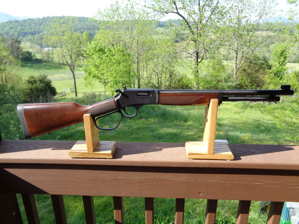

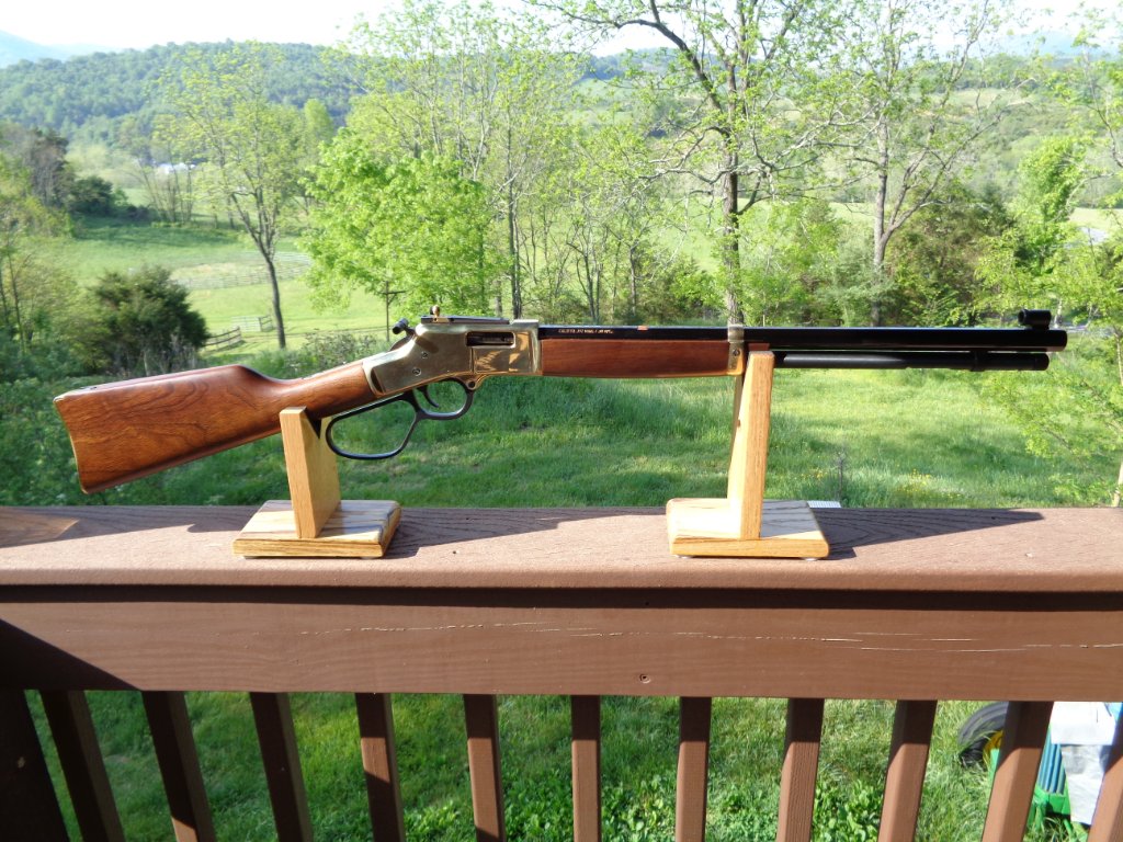

We have a Skinner Express/Lyman Globe on a brass BigBoy 357Mag and a Skinner Low-Pro/Lyman Globe on a CCH 357Mag BigBoy Carbine and steel 44Mag BigBoy Carbine.
Henry BigBoy 357Mag.JPG (222.69 KiB) Viewed 7117 times
Henry BigBoy 44Mag Carbine.JPG (219.5 KiB) Viewed 7117 times
The Globe sight on the BBB357 is a .495" Lyman 17A. The Globe sight on the Carbine is a .404" Lyman 17A. Lyman 17A Globes come in heights of .404", 495". and .584". My guess is that you would need the .495" version on a BBS357mag with a Skinner Express, but the failsafe method to find out is to mount the Skinner rear sight and then shoot the rifle to find out how it sights in with the stock sights. From there you can calculate what height front sight you will need to work with the Skinner - you want to put a front sight on that ideally will work with the Skinner's stem a couple of turns off the bottom position.
We use Lee Shaver inserts in our Globes - they give a much "finer" picture than the inserts that come with the Globes from Lyman. I personally like the cross-hair inserts that Lee Shaver makes.
