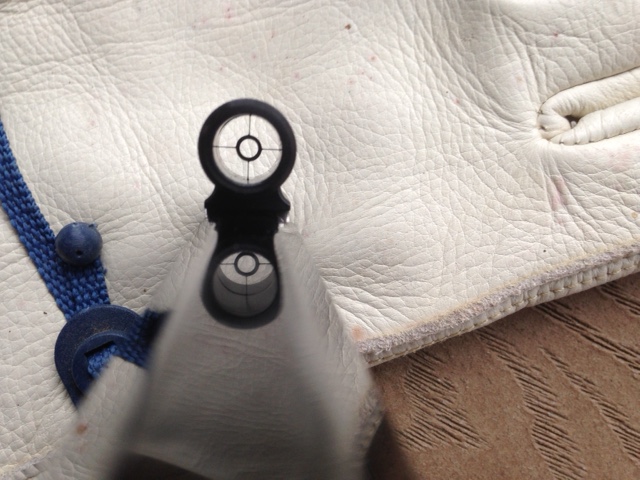

I have the BBB in .357 and .41mag and both wear a set of Skinner peeps and a Lyman front globe-I am 60 years old and the peep sights have made iron sights fun again.I have the ring installed in the front globe so it's like looking thru 2 rings at the target.

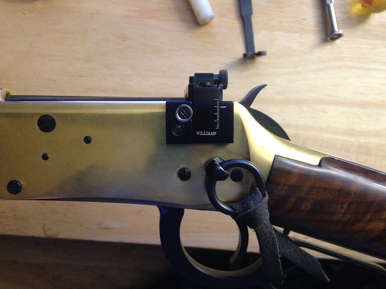

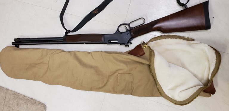

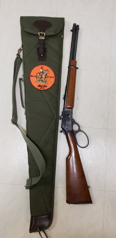

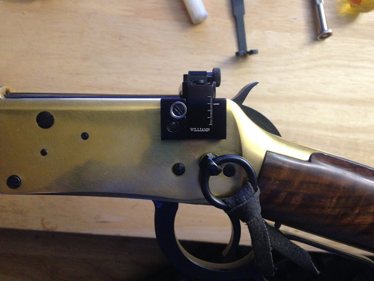

I use peep sights on both my Henry big boy steel and my marlin 1894. They are mounted on the receiver, my Henry is mounted on the rear of the receiver and my marlin I have it mounted on the front part. William's FP336 model peeps
Nitetrain40
Re: Recommend a sight setup - Big Boy Brass .357
Post by Nitetrain40 » Sat Apr 27, 2019 8:03 pm
Thos is the Henry with the peep mounted in the rear
Nitetrain40
Post by Nitetrain40 » Sat Apr 27, 2019 8:05 pm
This is the marlin mounted in the front of receiver

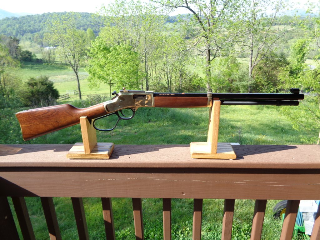

Our 357 BBB has a Skinner Express on the rear and a .495" Lyman Globe on the front - provides a much improved sight picture than the stock buckhorn/brass dot setup.
Henry BigBoy 357Mag.JPG (222.32 KiB) Viewed 3236 times
Lyman Globe.jpg (118.68 KiB) Viewed 3236 times
