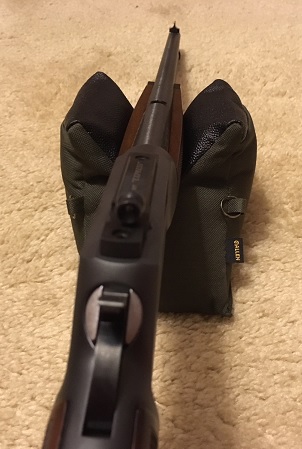

I took my new Skinner peep sight to the range for the first time today, mounted on my Henry BBS. Here are the results for 20 rounds at 50 yards, shooting PMC 158gr JSP 357 magnum. First 4 shots were left, so I moved the peep to the right to adjust windage. The elevation was all the way down, so I had no more adjustment vertically. The group is about 2 inches high, using a 6 o'clock hold on the red bullseye. Not sure that I want to go to the trouble of mounting a taller front sight, I may just shoot it as is. What would you folks do?
