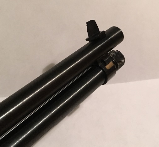

Thanks everybody for your input. The consensus seems to be install a taller front sight. So, for a 22 inch sight radius, 2 inches high at 50 yards, the Skinner website says I need a taller front sight by …
2"x22"/(50x3x12)= 0.024 inch.
That sure seems like a small number to me. Less than 1/32 inch !?
Can somebody check my math on this calculation?
Assuming my calc is correct, now I just need to remove and measure the height of my factory front sight to figure the necessary height of the new sight.

So today I measured my factory front sight at 0.556 inch high. That means I need a new sight that is a minimum 0.580 inch tall (0.556+0.024). BUT, this calculation only applies to the PMC ammo that I shot last week. It occurred to me today that I should have taken some other brands of ammo to the range with me, to see how much variation there is with the various loads. 0.580 inch may not be tall enough for some of the other 357mag ammo in my collection, including Aguila, Federal A.E., Magtech, S&B, Fiocchi, PPU.

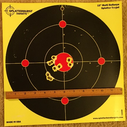

I took my Henry BBS to the range today to try out a variety of commercial .357Magnum ammo. I shot 10 rounds of each at 50 yards. The results varied from 5 inches high to 0 inches high, with my factory front sight:
Federal American Eagle 5" high.
Fiocchi 3.5" high.
Aguila 3" high.
PPU 2.5" high.
PMC 2" high.
Magtech 2" high.
S&B 0" high.
So, according to my calculation, I need a new front sight that is at least 0.617 inches tall, if I want to be able to "zero" my rifle with the Federal ammo.
0.556" + 5x22/(50x3x12) = 0.617"
Or, I suppose I could just stick with the S&B and leave well enough alone ... Nah! :)

At the risk of revealing my lack of marksmanship skills, I'll post my targets from yesterday. I used some 2"dia white labels that my wife had in her office supply stash for extra bullseyes so that I could use a single 12" splatter target for up to three different groups at 10 rounds each. After shooting the first 5 rounds of Federal A.E. at the white bullseye on the left, I couldn't see the holes in the yellow border with my binoculars, thought I was off the paper, so I moved over to the white bullseye on the right to finish out the Federal set of 10.

It's hard to explain what's going on here without witnessing it, but a) you're still getting used to a new rifle; and b) this new rifle really seems to like Sellier & Belliot, so stick with it!
I've had great luck with Fiocchi .357 in my BBS, so it's a head-scratcher.
That S&B grouping at 50 yards is beautiful, so the simple answer is "do that more!"
In other words, I don't think it's a sight problem, but others here may have different thoughts.
Keep working and keep sharing. Eager to see how it plays out.

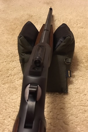

And, what sight picture are you using?
