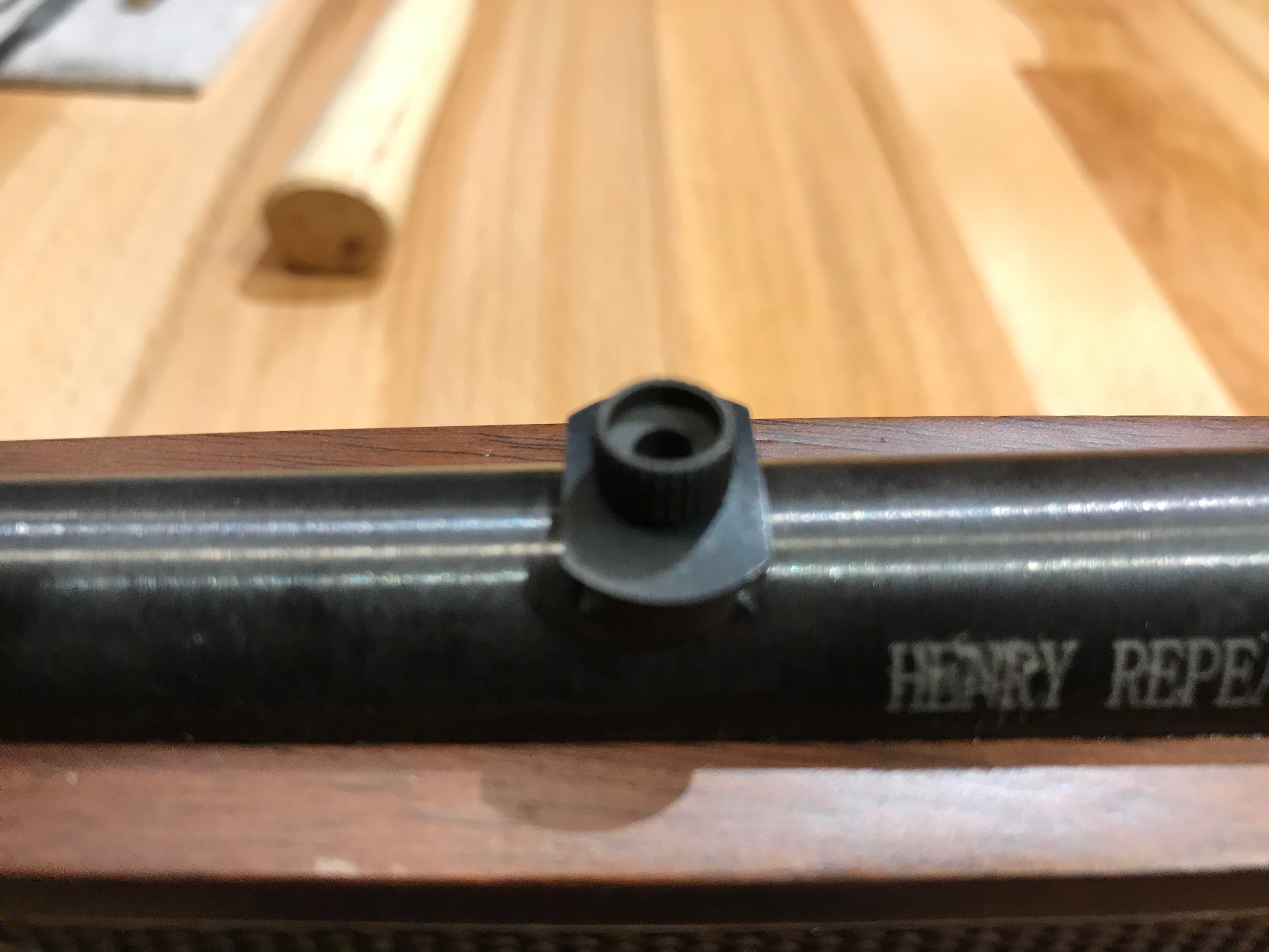

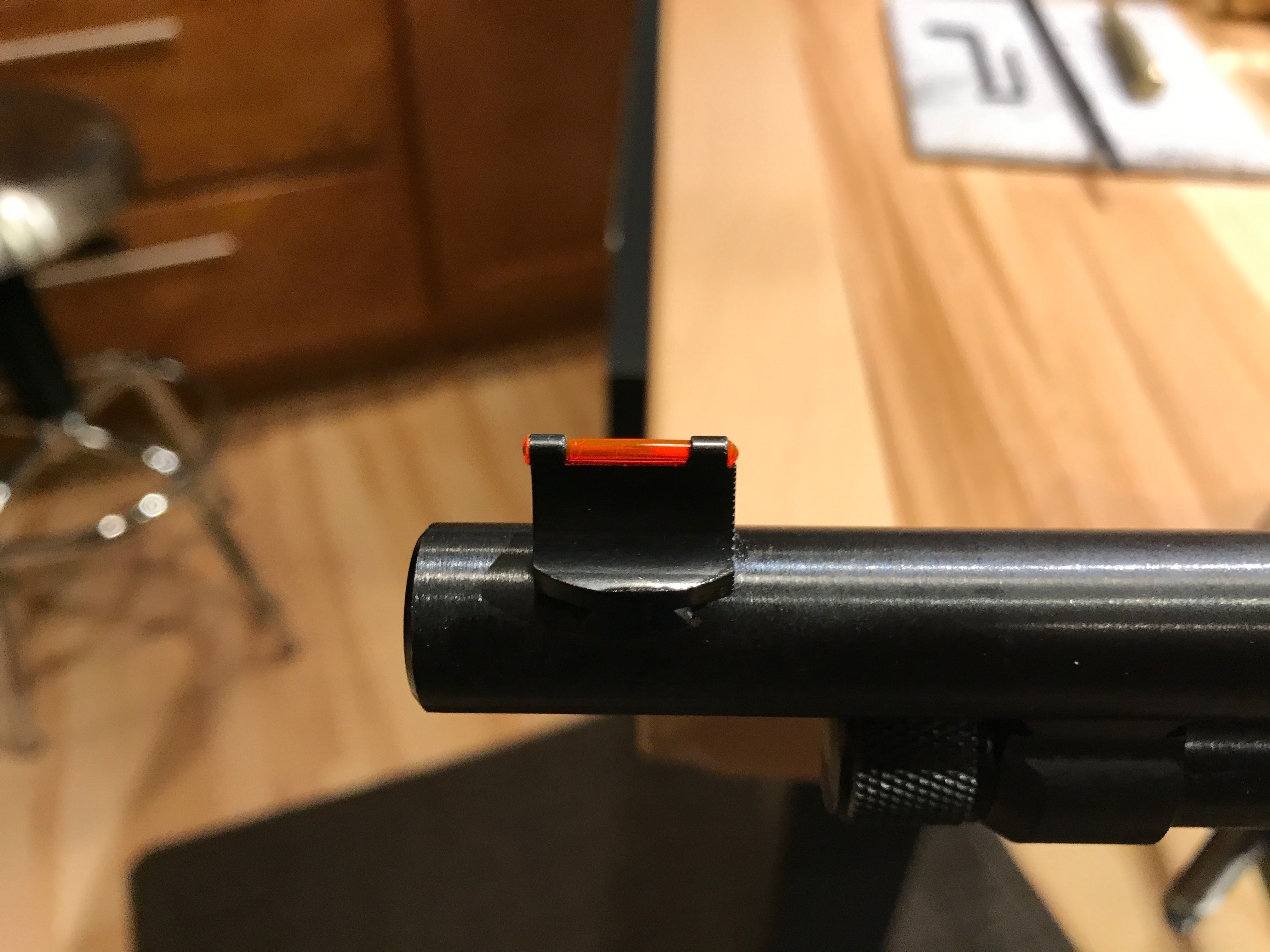

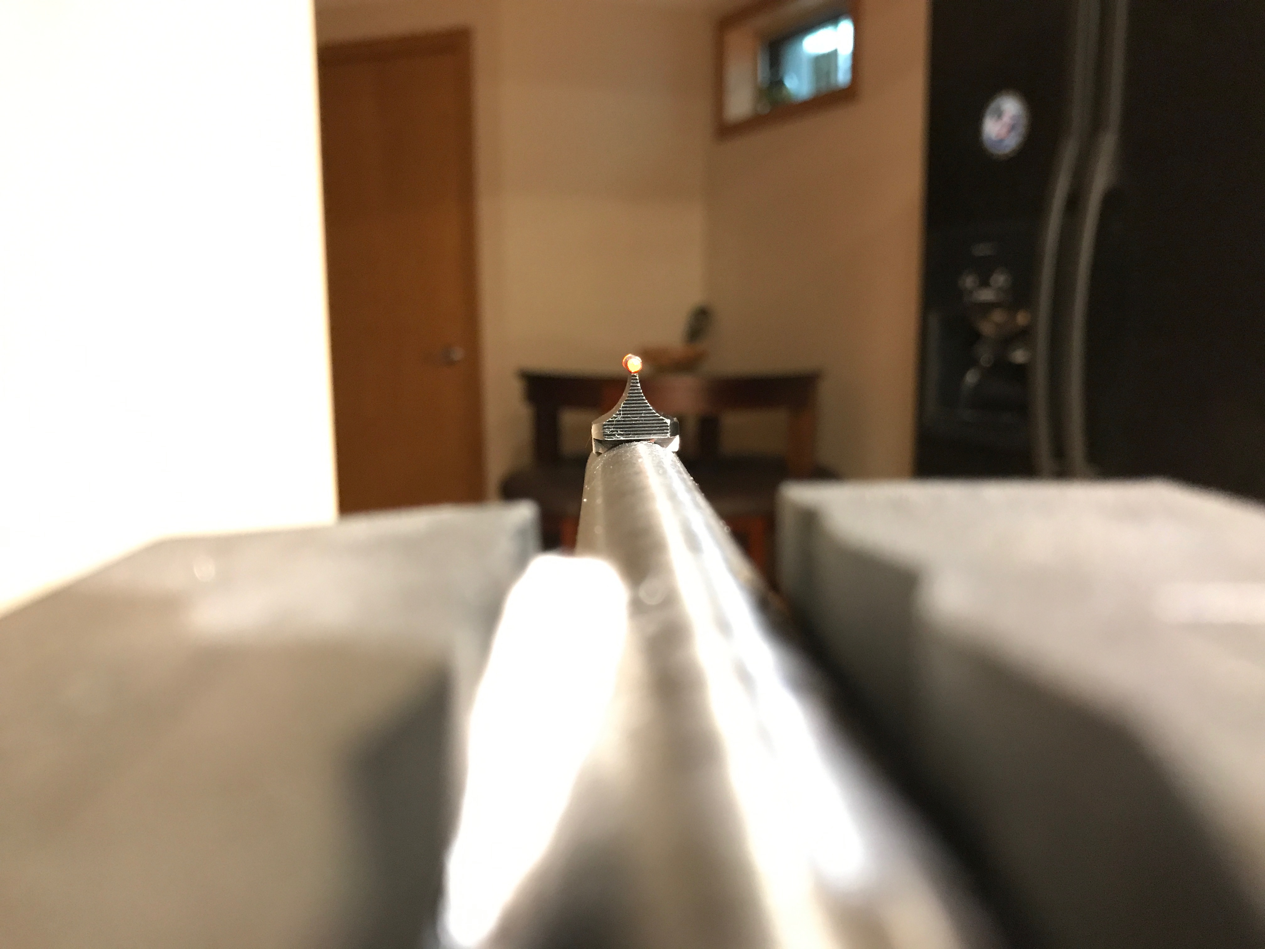

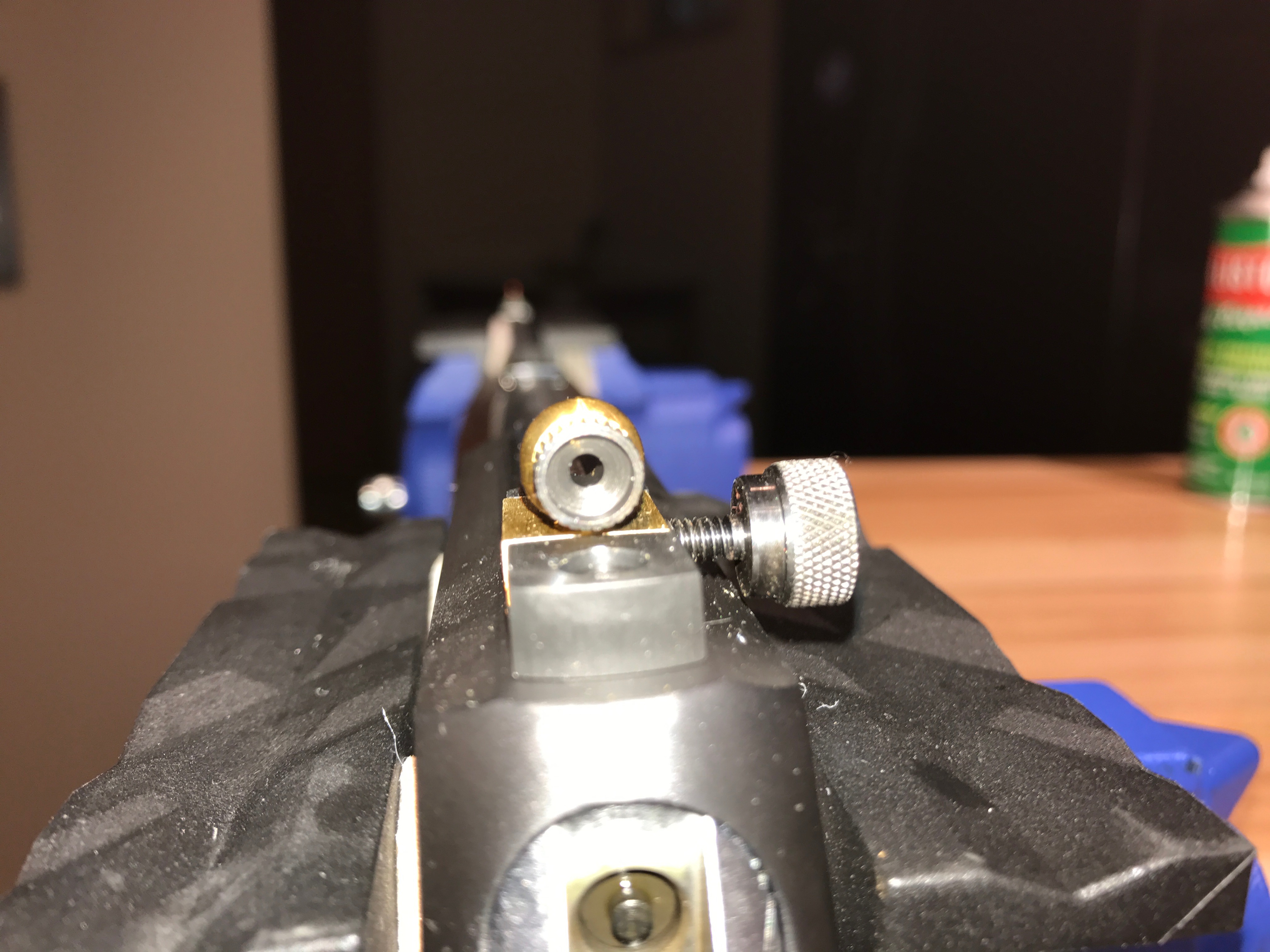

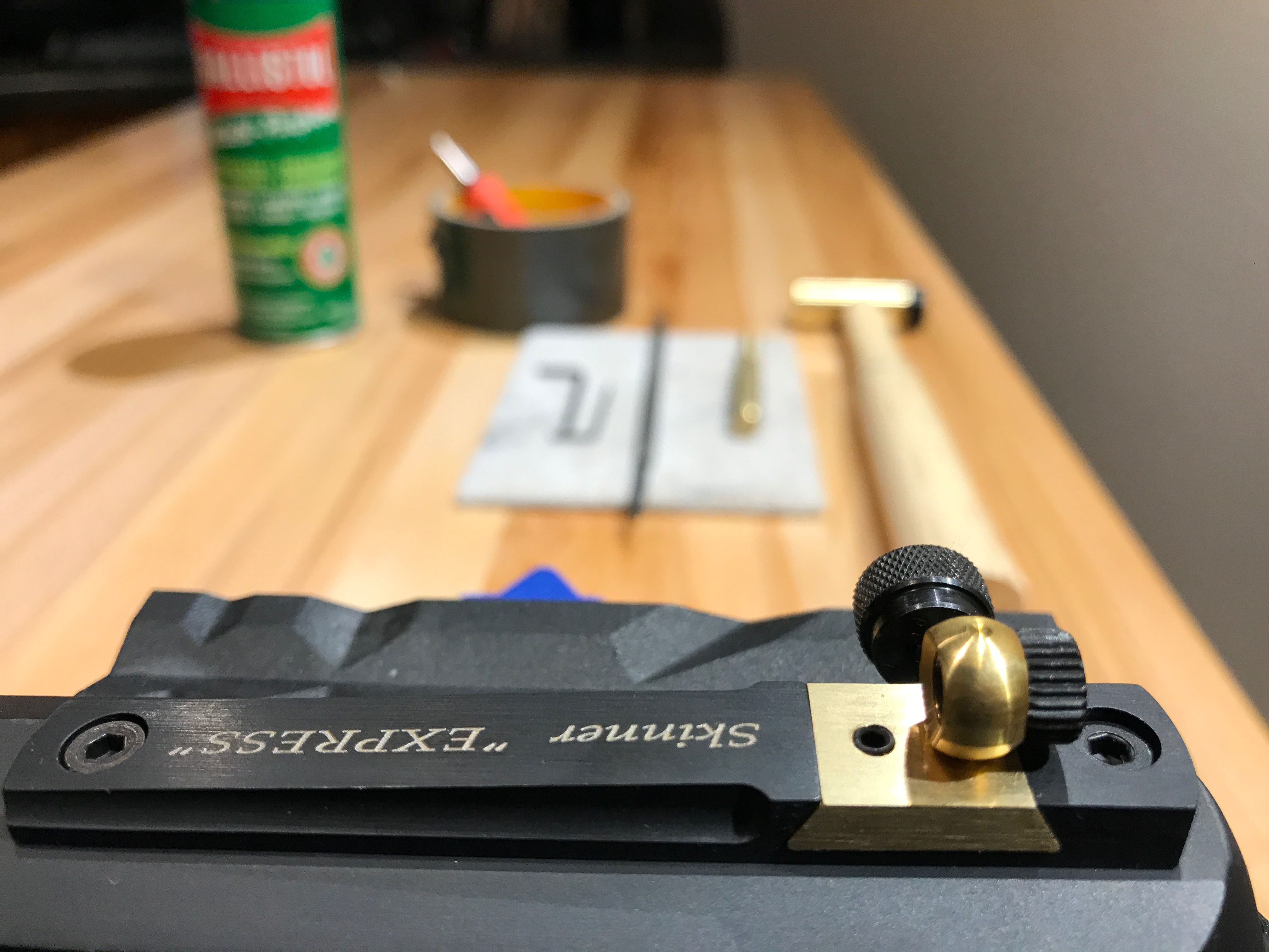

Peep sight with fiber optic front installed! Plus, took off open sight and installed the aperture slug from Skinner.

I really liked the sight picture, but unfortunately with bore sighting at 25 yards it was high at what seemed a couple of inches, but I was using a tree, so it could have been more or less. I was able to turn the brass aperture down one 1/2 turn by cranking on it with a hex wrench through the aperture, but no more. Unfortunately that did not help to lower the elevation sufficiently. It is still shooting high. Screwing in the black aperture that allows a tighter sight picture suggested I may have smashed some of the screw rings by cranking on the brass aperture ring, but the insert went in OK.
I will go to the range tomorrow and see what I get on paper at 50 yards. If unacceptable, the next step is to use the .70 blade sight I purchased and file it down. On my setup, the fiber optic is not tall enough to allow any lowering of the windage. I wonder if others have tried this setup and to what outcome.

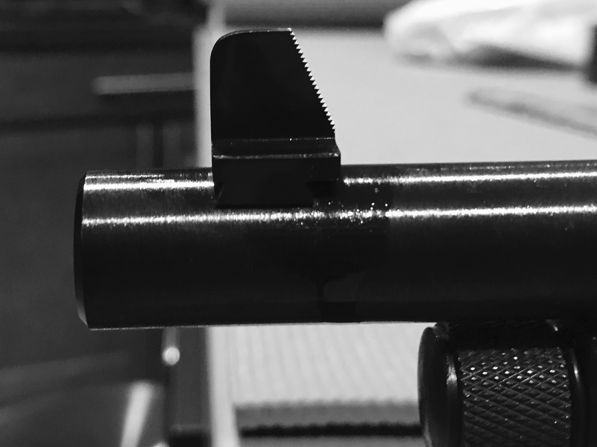

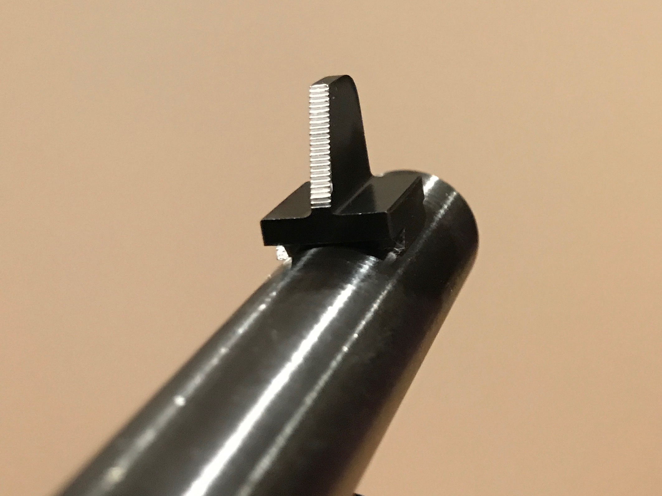

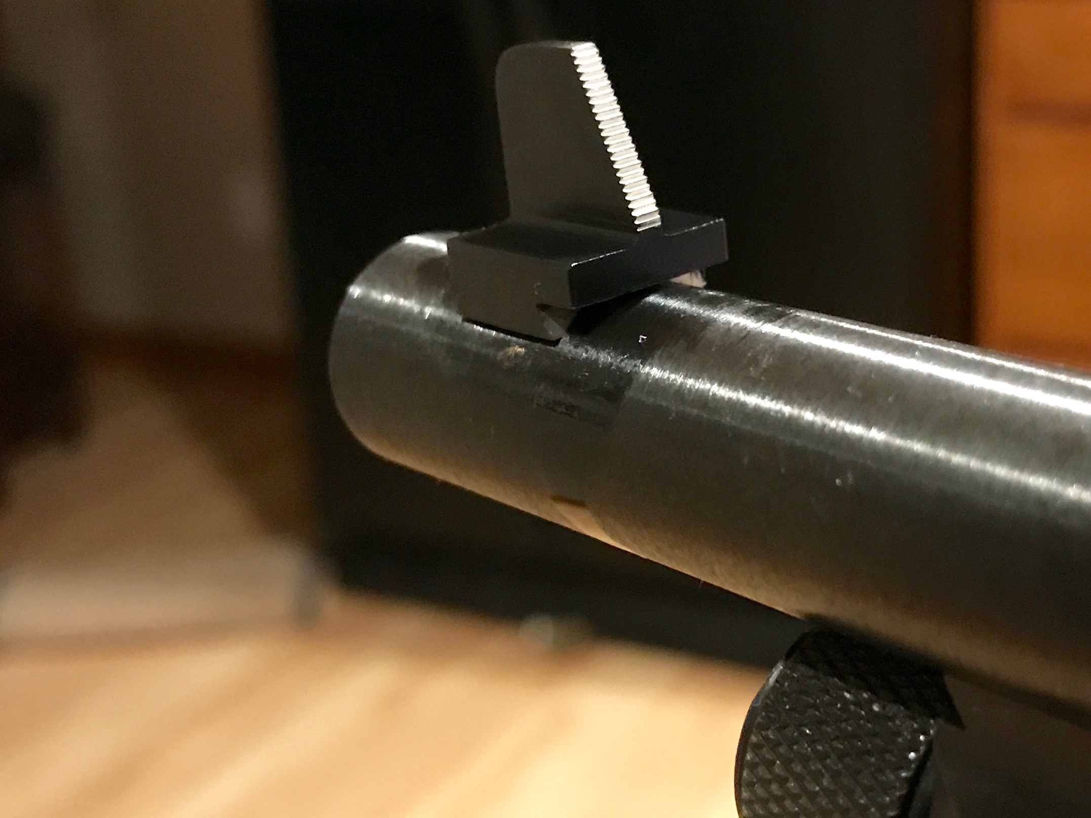

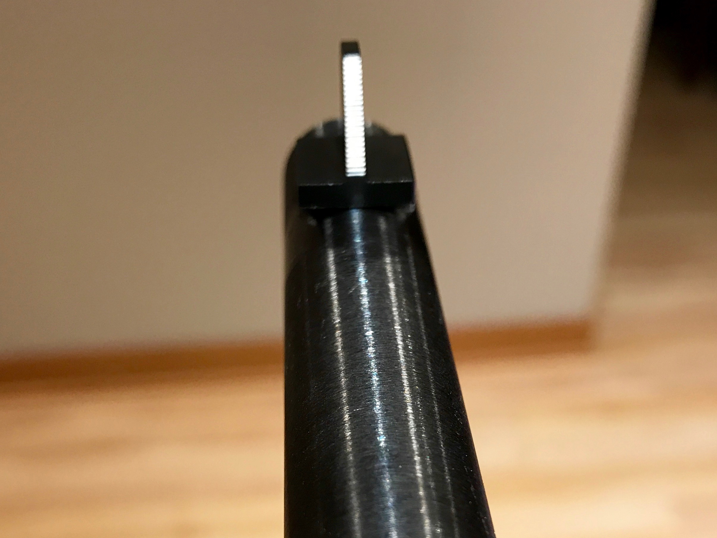

Punched out the Skinner fiber optic, punched in the Skinner front blade sight. Sits high (and not so aesthetically pleasing), but affords the opportunity to file it down, as necessary. The goal is to get POI a bit higher and with the fiber optic (seeming the same size as factory, there was no room to lower the Skinner Express sight for adequate adjustment, so that's why I am now putting in the taller sight). I used Skinner's three sided file with one side smoothed so that only the sloped part of the dove tail is removed. The file works well. I then put on Skinner's blueing and after a couple of minutes, some lubricating oil, which shined up the otherwise fairly flat black sight. On the second image from top you can see some brass marring on the barrel--I did tape it off with duct tape, but still it broke through. Ballistol will hopefully take it off or I'll use a copper solvent. Didn't see it with the naked eye. BTW, I painted the front of the sight white, it doesn't come that way.
This process of substituting sights is a bit tedious; hopefully, it will be worth it! Next step--bore sighting. I used a neighbor's bore sight last time, recommendations for purchase of my own?

Thank you. I may try the Lyman Globe if the blade sight doesn't work.North Country Gal wrote:I use globe sights almost exclusively on my air rifles that are setup with iron sights, using either a peep or open sight for the rear sight. The interchangeable inserts give you all kinds of options for the front sight, everything from a blade, aperture and so on. You get just about any kind of front sight you want, just by changing the insert. The only issue with going with a globe front is that globe front sights usually sit higher off the barrel than what usually comes for a factory front sight, so you may need a rear peep sight with plenty of elevation adjustment. Haven't tried the peep/globe setup on a Henry, but I'm sure others have and will give you all the help you need on that one.
For precision target work, I prefer a blade for its sharper outline against the target, compared to a fiber optic. That sharp top on a blade allows for a more precise hold. The top of fiber optic sights tend to be a little less sharp. On the other hand, for hunting back in the timber, a fiber optic sight's visibility is awesome in those lowlight hunting periods. They really do work. I don't hunt, anymore, but have specifically tested them with other sights in lowlight periods, just out of curiosity.

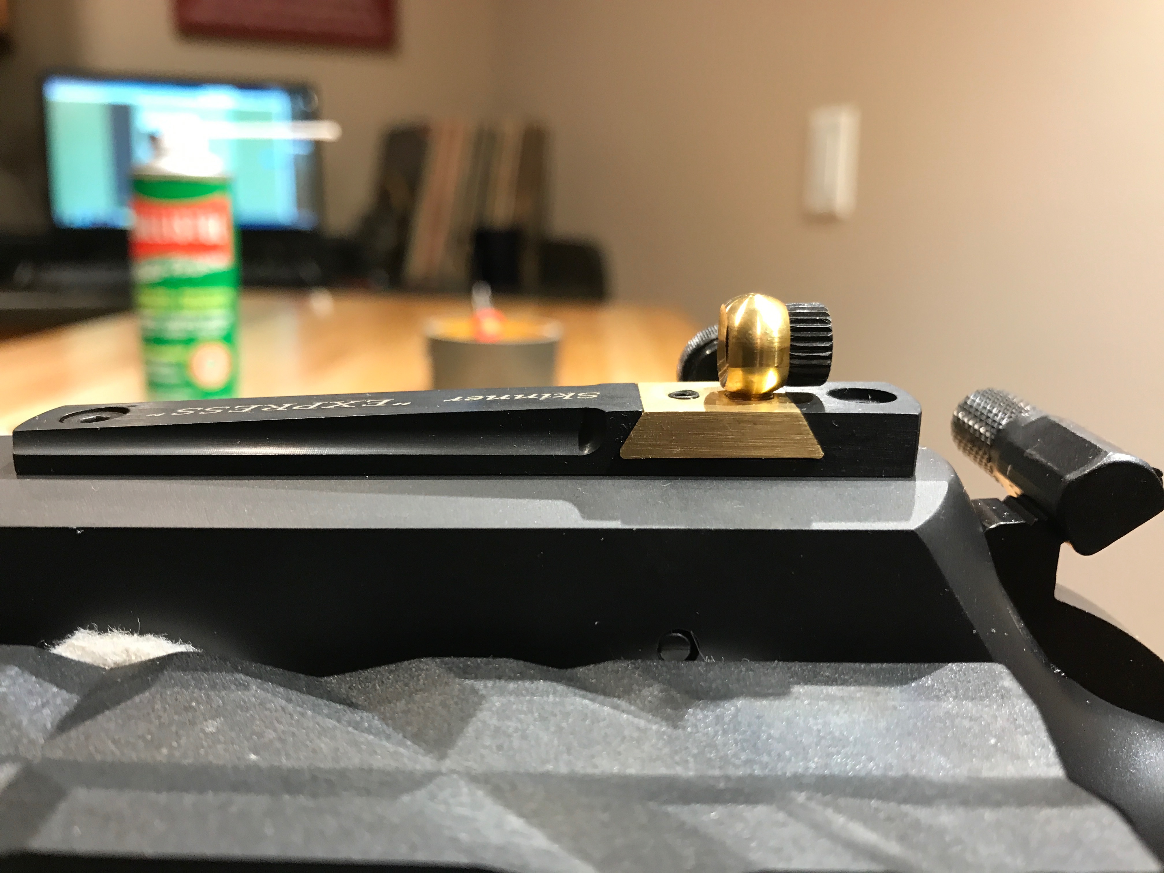

As mentioned above, I swapped the fiber optic for the Skinner blade front sight and painted the front white.
I then unscrewed the Skinner short-stemmed aperture about 1/2 way out and tightened it down and went to the range today. I have room with the Skinner Express Sight now to raise and lower shots.

In summary, I like the Skinner Express Peep Sight mounted on the receiver, but finding the right front sight was a bit of a challenge. A blade that has a vertical adjustment would be challenging to engineer but would solve the problem (Tech Sights has one for 22 caliber rifles and I put his set on my Marlin 795; have not shot it yet!). I found the Skinner tall blade, I believe it was .70", worked with the Skinner Express Sight and so far, no issues at 25 yards. When I get it out to 50-75 yards and working fine, I will call it a success! One follow-up to come.

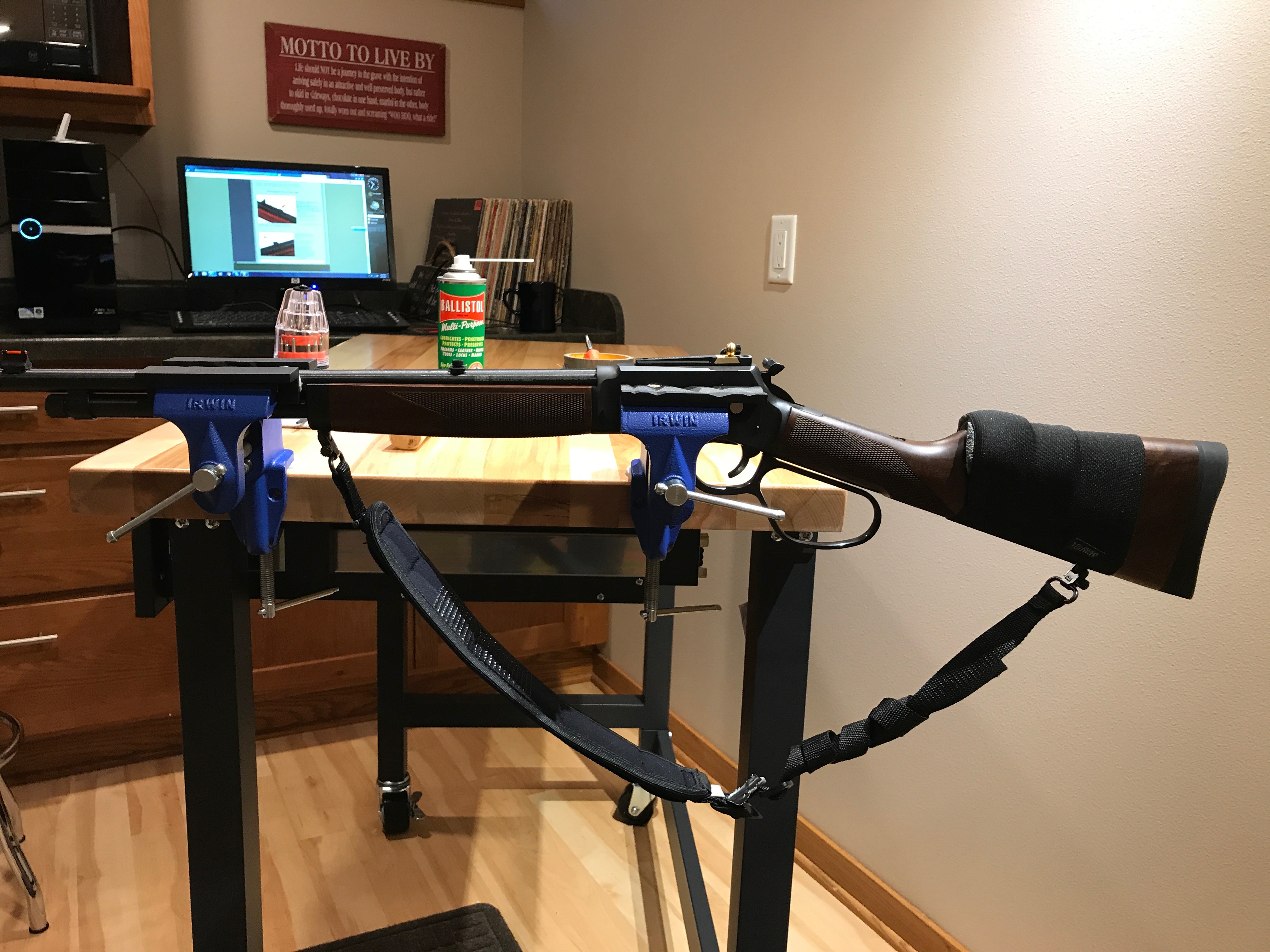

Like those vice's, did you make them,??????? if so, what did you use for jaws, to keep from marking the weapon, thank Mike

I wish I had the skill to make vices. I purchased them on Amazon, along with protective inserts on the vices (see below). I also used felt, floor protectors on the vices for added protection--bought a package awhile ago. I hope that is helpful.Whaler17 wrote:Like those vice's, did you make them,??????? if so, what did you use for jaws, to keep from marking the weapon, thank Mike
[urlhttps://www.amazon.com/gp/product/B0001LQY44/re ... UTF8&psc=1[/url]
[url]https://www.amazon.com/gp/product/B018Q ... &psc=1/url]
