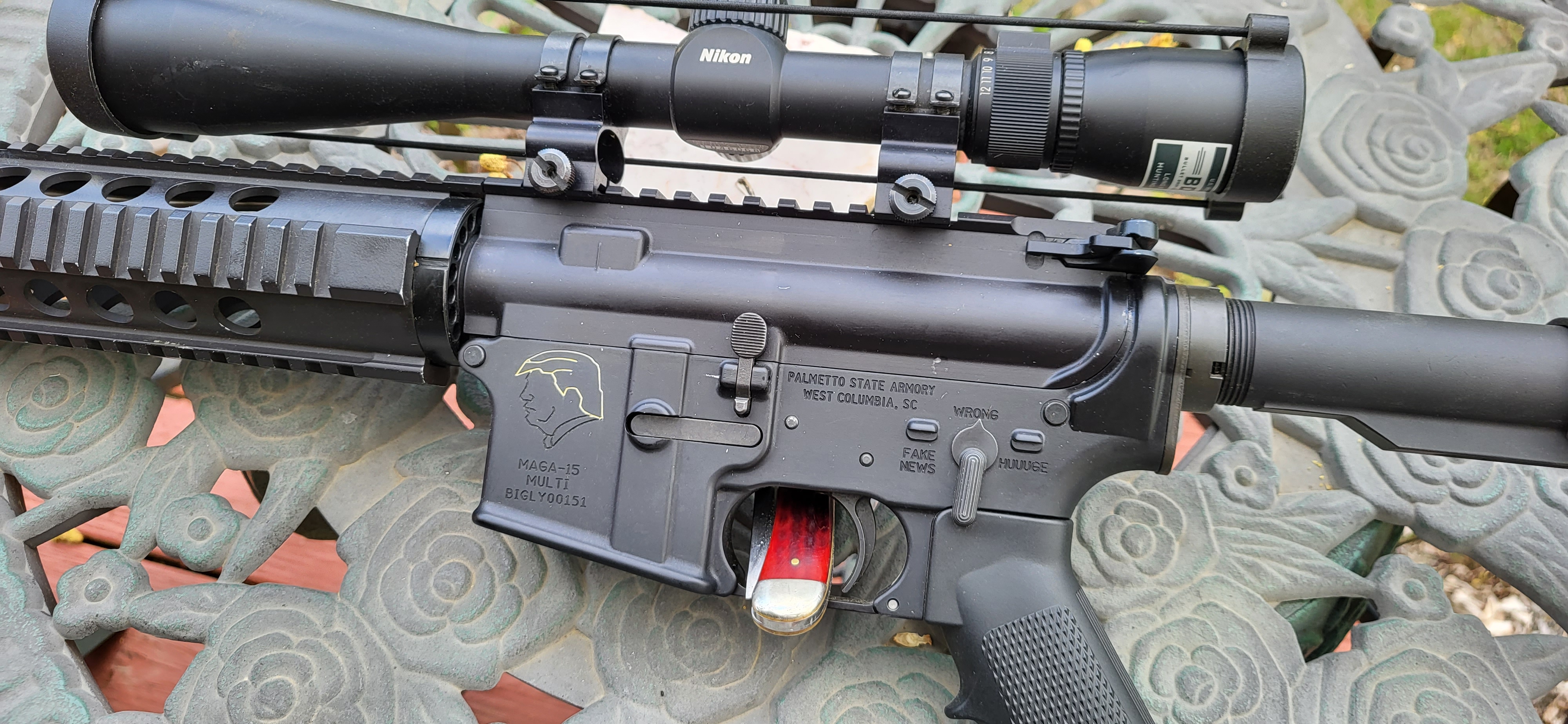

I went with a 4-12×40 and a set of med height rings. I don't remember the brand, it's been setup like this for several years without any issues.
Never got a chance to use it on any coyotes yet. The number 2 grandson took three deer with it year before last with it.
The lower came stripped and I built it myself, the came complete and both from PSA.

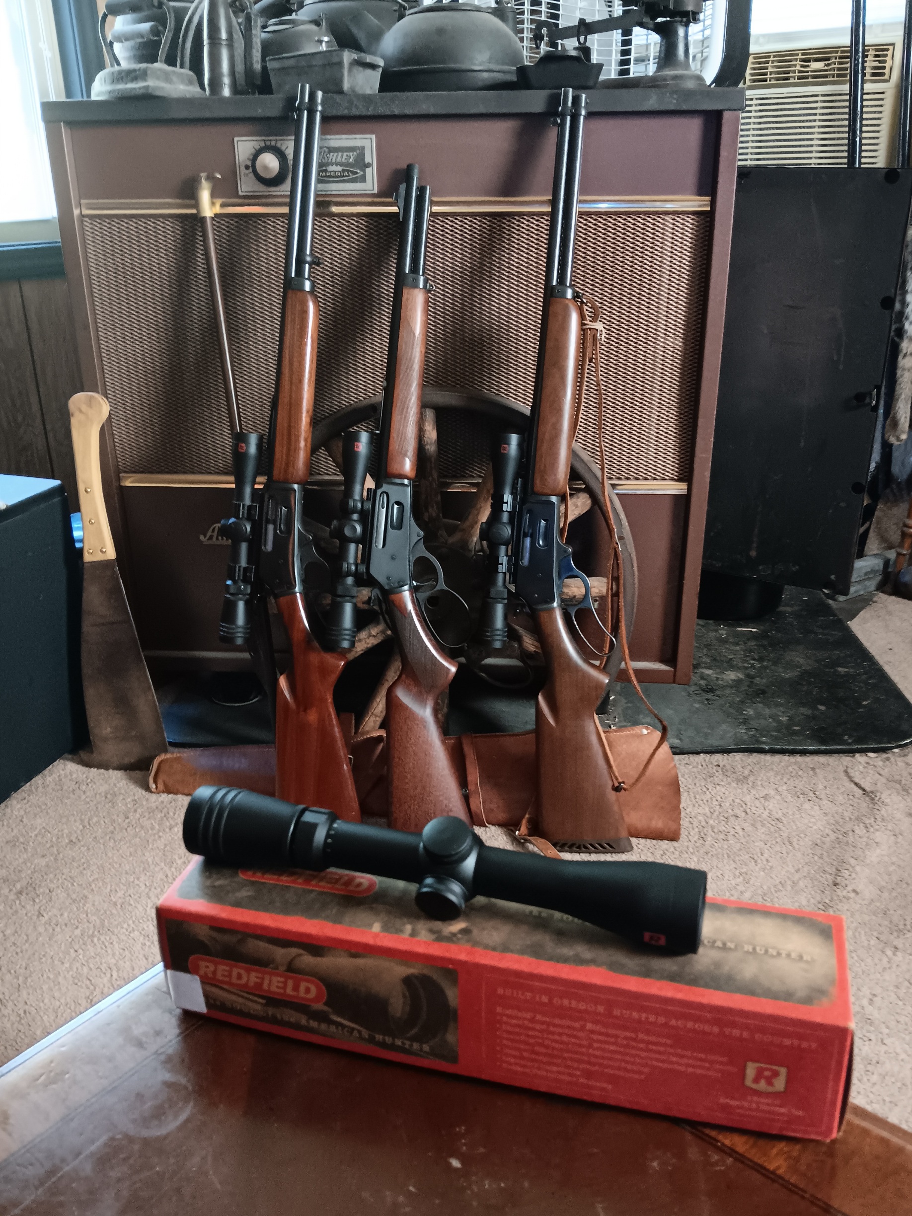

Hey Henry fan, man I love those Redfield Revolution scopes.
I have 4, they now cost more second hand than they did brand new.
Perfect levergun scopes in my opinion.
