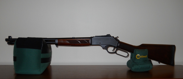

I just received my new H024-3030 rifle and am getting ready to hit the range next week. I'm concerned about the ability to adjust the factory buckhorn enough to sight it in. FWIW, I also have a Henry Steel 45-70 lever and wasn't able to lower the Buckhorn sight enough even to get on target at 25 yards. I even removed the adjustment ramp. No soap... I ended up scoping the rifle and ditching the buckhorn entirely.
I do have a question though... The white diamond marked slide That slides/fits/locks in the buckhorn, can I grind a bit of it's lower edge to allow it to sit lower in the buckhorn? Are there any other tricks or modifications that will allow me to get it sighted in with the buckhorn sight?
If I can't get the buckhorn sighted in I'm considering going with Skinner's barrel mounted peep sight. I don't want a receiver mount as I like the handsome brass receiver unfettered with a sight/scope/red dot. The Skinner barrel mount also allows one to retain the existing front sight too. Any tricks, suggestions or opinions on it?

I suppose out of the factory each H024-3030 might turnout slightly different. On mine, the sight zero'd one ramp step below mid ramp. You could grind the insert some as long as the side set screw can still lock it in place. Just be aware that the insert is flip-able. One end up is a V notch and other end up is a U. By grinding you'll destroy which ever notch you're not using.

Some have reported that Henry sights each rifle in at the factory, which isn't true. I talked with them this AM and they only fire it to ensure it fires OK, nothing to do with sighting. Hopefully I won't need to grind the slide. If I do it won't be too much. Fingers crossed...

Well... Made it to the range today determined to sight in the 30-30 with Buckhorn sights. I brought my brass drift but forgot my small hammer. I ended up beating on the brass drift with my staple gun, not the best thing to use. I ended up starting at 25 yards and then 50 yards, about as far out as I want to go with Buckhorn sights and my 72 year old eyes. More than likely I won't be hunting with it, just target practice at the open air county range. I'm OK with the initial results and plan to improve a bit on my next range day. The Buckhorn required windage and elevation adjustments. At least I don't think I'll have to replace them with a peep sight. If I end up replacing it I'll use Skinners barrel mounted sight. I want to keep it as original as I can. Opinions on the barrel mounted peep?

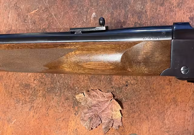

I've used the Skinner barrel mount peep on over a dozen rifles. Always keep one around just in case I get another rifle I can't scope or add a receiver peep. With the barrel mount peep, I've yet to need a taller front sight. My favorite way to use the barrel peep is ghost ring style (no aperture added). Makes for very quick acquisition. Perfect sight for a short range woods gun.
In fact, I just switched to the barrel peep on my Ruger No. 3 in 45-70. Was using a barrel mounted red dot, but it just didn't seem right with a single shot 45-70, either for looks, tradition or for the way the red dot sat so much higher than the Skinner. Had to pull my cheek too high up from the stock. The No. 3 is stocked perfectly for use with iron sights. The Skinner seems like it was made for it.
