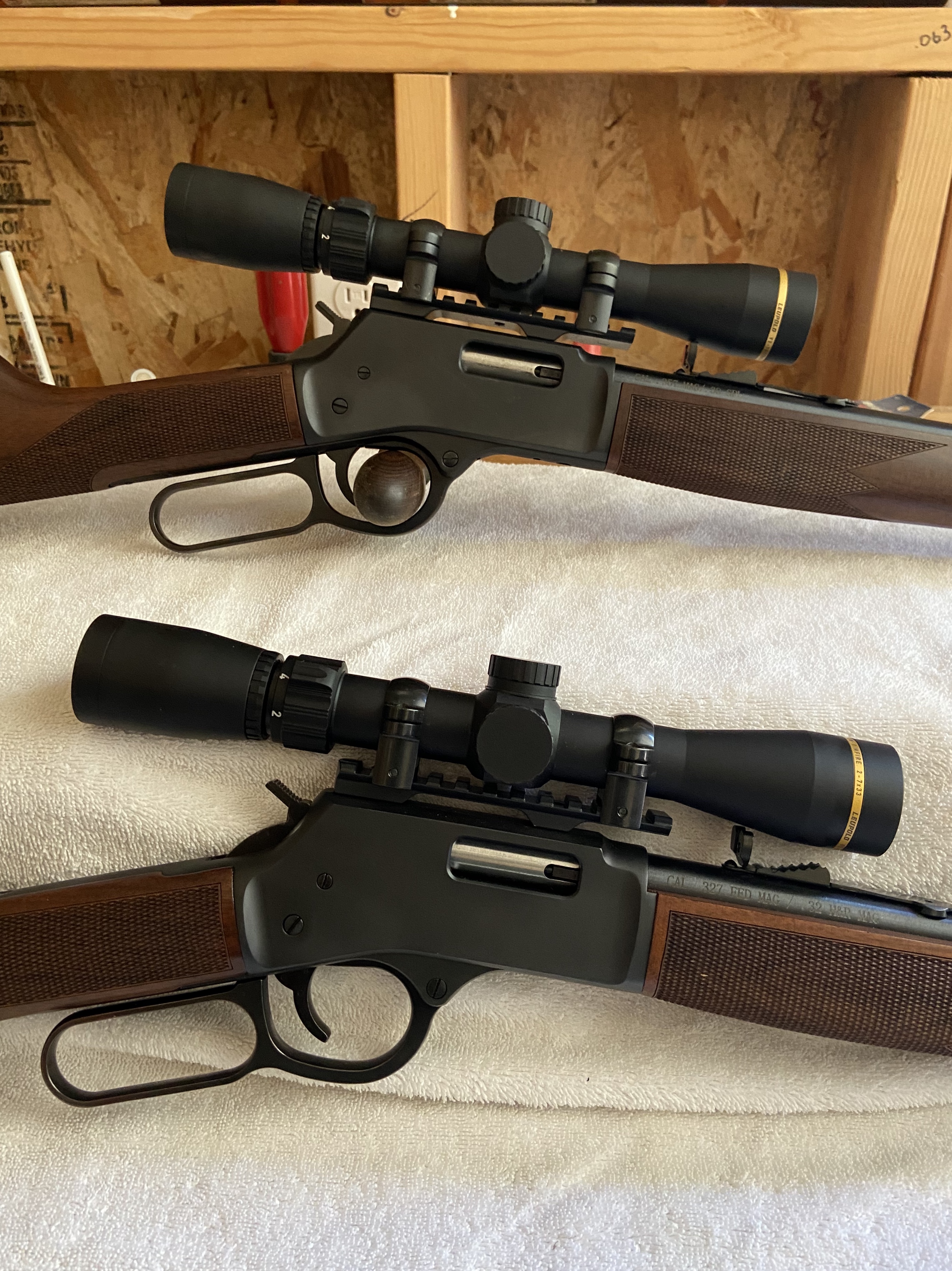

On my BBS 357 I used the Henry picatinny mount and medium heights rings to mount my Freedom 2-7x32. It cleared the hammer well enough that I didn’t use a hammer extension. This setup barley cleared the rear sight. Your scope will have a 40mm exit so may need to be mounted higher. Also hammer clearance will be affected by how far forward/rearward you mount the scope for your eye relief. I found with the Big Boy stock I need a cheek riser to properly align my eye with the scope. You’ll see in the last pic how close the scope is to the rear sight. But if your scope is mounted more forward the clearance increases. Sure wish Henry put a folding rear sight on these rifles.

I have the same mount as Hatch on my 41BBS.
I did not really need the hammer extension, but I like them and they do make pulling the hammer back easier.
Especially in a hunting situation. 😉I have them on most of my scoped leverguns.
