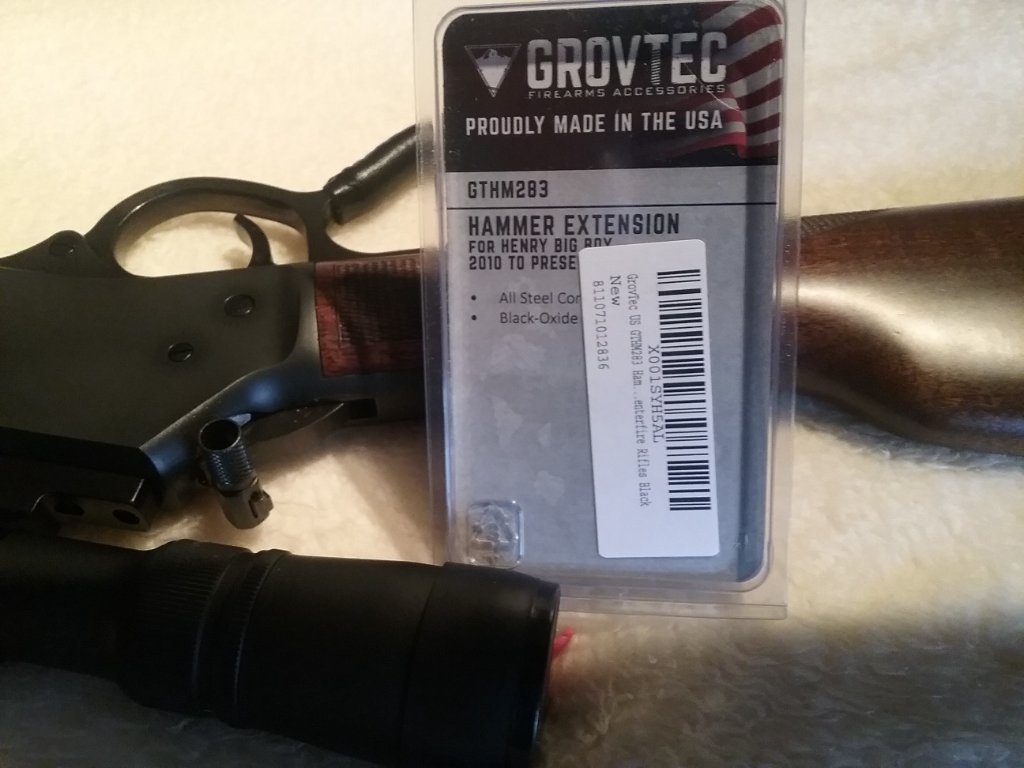

Hey Henry fam...just mounted a Vortex 3-9x 50 with Henry's base/rings assembly on my AW Big Boy. Nice optic, very clear sight picture, but clearances are minimal and hammer is somewhat obstructed- and I'm not convinced the eye relief is optimal given the positioning constraints. 50mm seems possibly overly large for this gun, although I appreciate its superior light gathering and FOV compared to lesser objective lens' diameters. Did I buy too much scope for this gun? What are you all running with yours?

You can get an extension for the hammer that sticks out to one side our the other to allow easier thumb cocking or decocking as needed. It's a common problem with a simple solution.
From the Henry parts page:
https://henrypride.com/collections/rifl ... bidextrous

I think the hammer extension is a great idea. Just cycling the empty action a few times to check the ergonomics with the mounted scope, there was a slip or two letting the hammer down. Not good! And that was without the adrenaline dump. Opted for the ambidextrous extension; maybe I'm overthinking things, but went that route thinking the gun would wear evenly with equal weight coming down on each side of the hammer.

I shoot both left and right so having it extend on both sides would work better for me.

50mm seems large and and optics will require hammer extension install.
