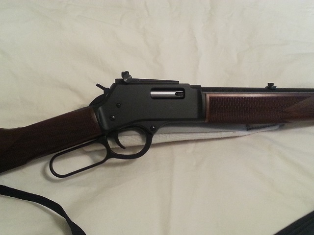

Results from the Range with the Skinner Peep Sight project:

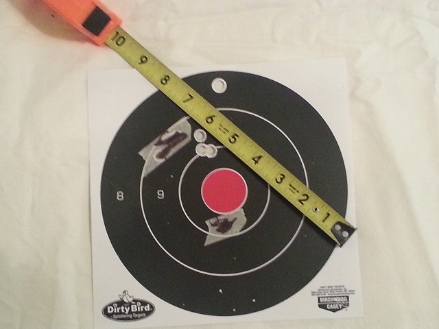

Looking at targets from 53 yards.

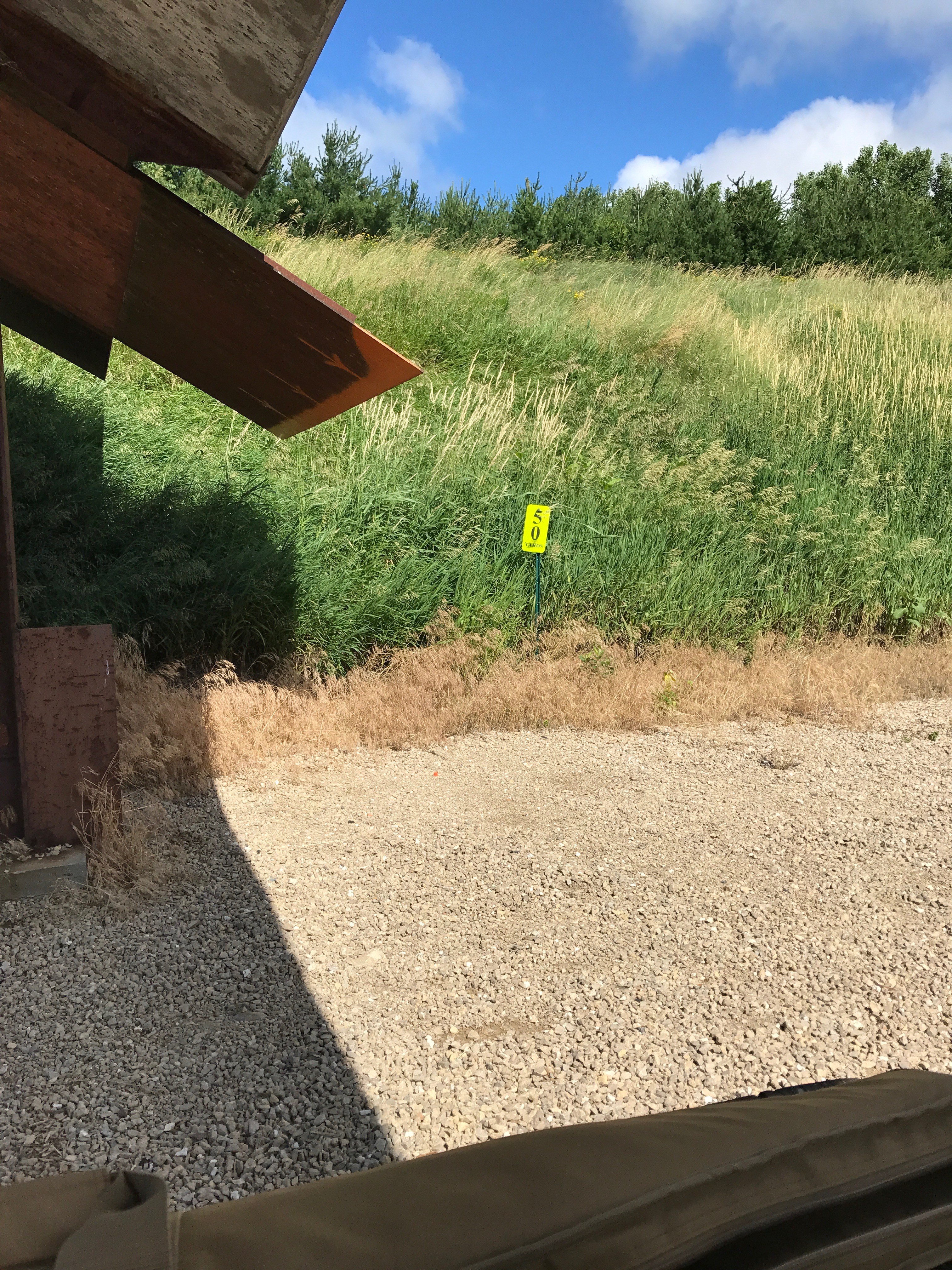

50 yard marker.
50 yard marker.
First three shots from bench at 53 yards (1 x 1" red center target).  Without 8 power binoculars, I had no idea!
Ten shots total from bench at 53 yards

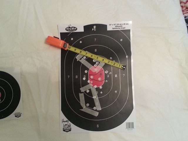

Off hand, standing from 53 yards with a larger center target (2 5/8 x 3 1/2"); I thought 3 shots were taken.

Conclusion: I am satisfied that in my hands at 53 yards the Henry 357 Steel Carbine fitted with Skinner Express Rear Sight and front post sight, will do it's job. I haven't tried 75 yards yet, but I struggled to find the red dot (1x1" square approximately) with my vision. Given my off hand shooting at 53 yards, I need much more practice before I will feel comfortable with accuracy. I will move to a larger center target for off-hand shooting and see how that goes before I consider a scope for my Henry. I had 1-2 failures to feed with the lever at the range today, but that was operator error. I did have to send the Henry back for service because the extractor caught on the receiver a couple of times at the range two weeks ago. Henry did some demurring and polishing and improved the functioning. New to Henry and customization, this has been an interesting and satisfying experience.

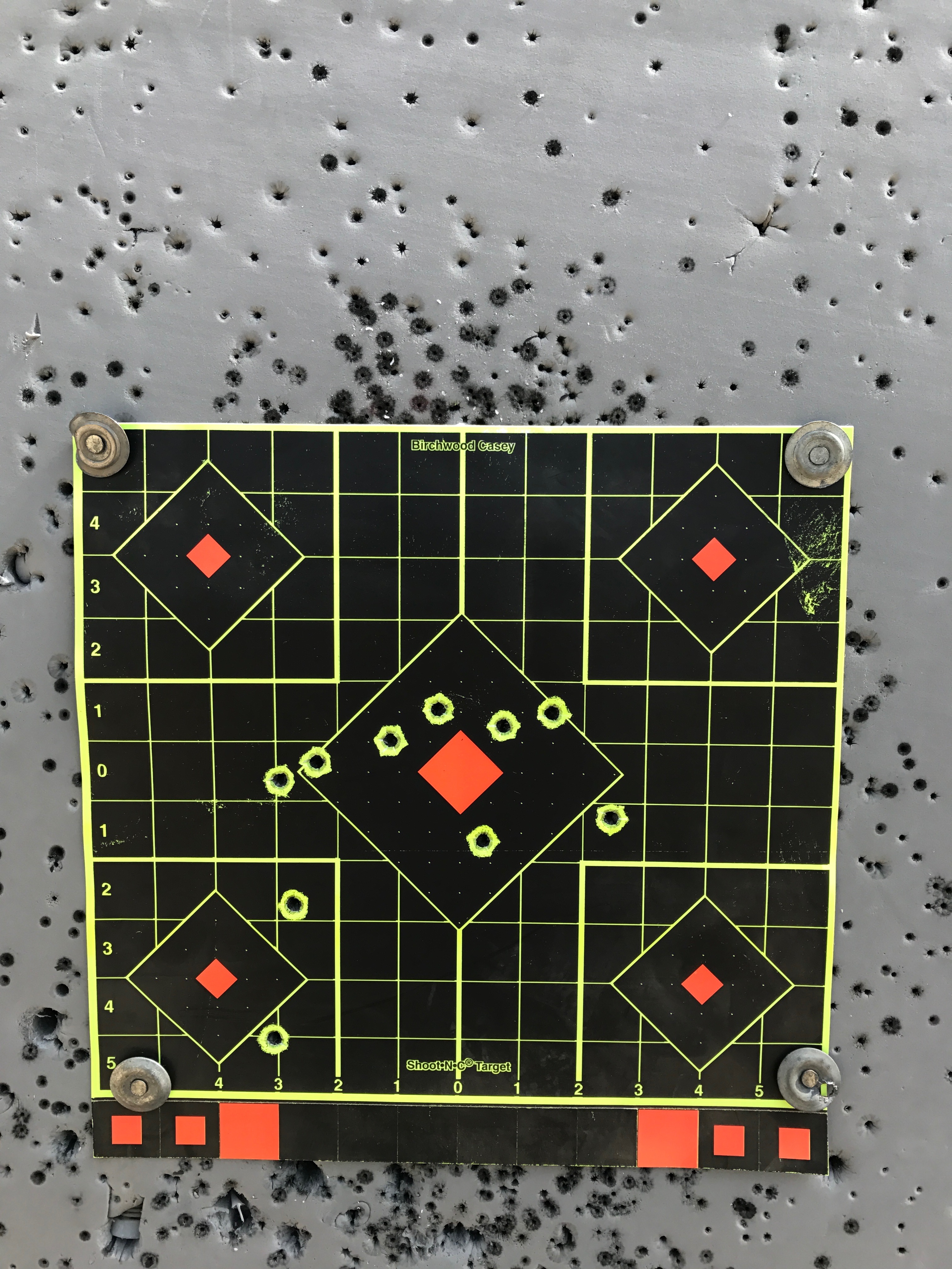

I wanted to get better groups with my big boy 357 than with the buckhorn sights so I installed receiver Skinner sights. With just the receiver sight and Monarch 158gr SJHP I grouped very high at 25 yds. with the aperture post 1 1/2 or 2 turns from bottoming out. I used the Skinner front sight formula after talking with Andy at Skinner to determine that I needed a .200 taller sight which was the .760 tall. That took some getting used to but the rifle looks great. I also got the extra aperture barrel blank and the elevation lock knob.
When I got to the range again I used a rolled up towel as a bench rest and the .040 aperture to sight it in. At 50 yd I grouped less than an inch with three shot groups. I got about 2 1/2" groups at 100 yds. though I was still setting the elevation. I think there was two post turns between the upper and lower groups. The circled center group shows it dialed in. The remaining shots show a group with the larger standard aperture, just the ghost ring as I used my remaining ammo and another caliber I was sighting in too (why waste a target?).
The longer sight radius along with the small aperture make this as accurate as I need and this upgrade was well worth the price. My next range trip is to try offhand shooting with the standard aperture.

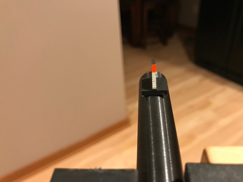

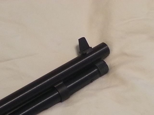

The white blade sight got lost in bright light so today I added some Testor's fluorescent orange and hope to get it out to the range soon.
