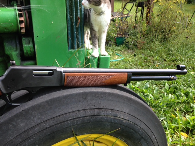

Resurrecting this thread. Skinner doesn’t list the Lo Pro sight under its Henry options, so I missed it. For those that ordered it, I presume it’s the 8-40 thread like the Marlin? I was considering the Express, but now may go this route.
BBSC .44 Magnum with Skinners
1912 Winchester 1894 .30 WCF
tractortad
Re: Which Skinner Sight for 357 Steel Carbine.
Post by tractortad » Wed Sep 12, 2018 1:07 pm
Redthies wrote:Resurrecting this thread. Skinner doesn’t list the Lo Pro sight under its Henry options, so I missed it. For those that ordered it, I presume it’s the 8-40 thread like the Marlin? I was considering the Express, but now may go this route.
You presume correctly - order the 8-40 thread for a Henry BigBoy. Here's one on a BBS 44:
