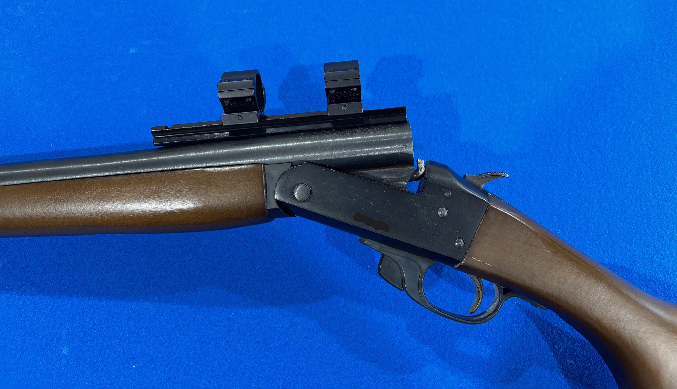

I have an old Stevens 9478 in 12 gauge. It's also a single barrel, break action shotgun. It was a 28", full choke barrel originally, but I cut off 3 inches, so now it's 25" cylinder bore. I bought this a long time ago, when I lived in NJ. There was a short period where they allowed slugs for deer hunting, but not rifled barrels, and I modified this shotgun for that purpose. I drilled and tapped the chamber of the barrel, where it's thickest, and mounted a Weaver base, I forget which one I used. The chamber area is a cylinder with parallel sides, and the barrel tapers after that, so only three screws hold the base on, and the end out towards the muzzle extends out over that taper a bit. All three tapped holes are blind holes, meaning they do not go all the way through, into the chamber. I remember the machinist at work helping me do it, and he said it would be better done on the mill, but I set up the depth stop on the drill press and did it on that. I used to have a Simmons Deerfield 2½ power scope on it, but that scope migrated to my Winchester 1200 when rifled barrels were eventually allowed for hunting.
So yes, it can be done, and a competent gunsmith should be able to take care of it for you.
