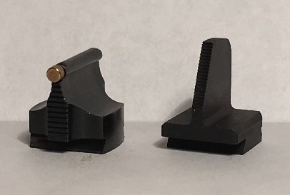

So I finally received my new Skinner front sight. I ordered the one advertised as 0.650 inch. I measured the height as-received at 0.666 inch. The original Henry sight measures 0.556 inch. Here is a photo of my original Henry sight (left) next to the new Skinner sight (right). With family visiting from out of town, I probably won't be able to fit/install the new sight until later next week.

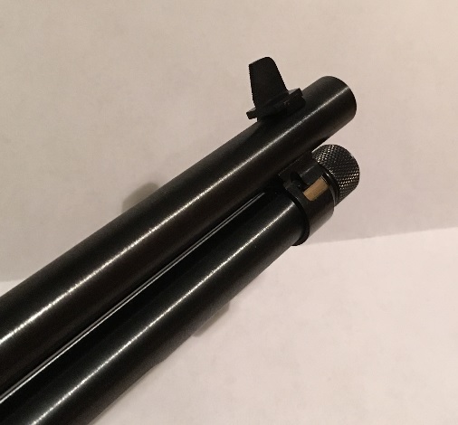

So this week I mounted my new front sight and a dovetail blank to dress up where I had removed the factory buckhorn sight. Took about 1.5 hours to do both, including filing the dovetails to fit, applying the cold blue to the shiny parts, and then tapping into place. I deliberately went slow, so as not to screw things up.
Took the rifle to the range yesterday. With the now taller front sight, I had to raise the rear peep sight 2.5 rotations to get the correct elevation. No need to file down the front sight, for which I am glad. This is 10 rounds at 50 yards after making the elevation adjustment. A 2.75 inch group … I think I'll keep it!

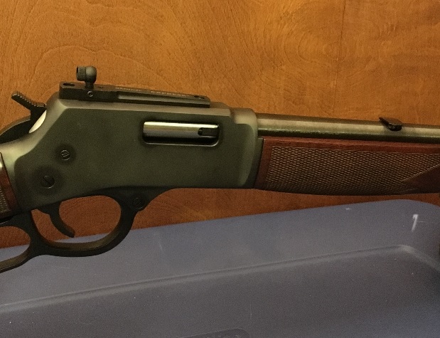

One more photo showing the Skinner rear peep and the dovetail blank that I installed.
H012M Big Boy Steel .357Mag/.38Spl
NRA, ISRA
Posts: 8837
Re: My New Skinner Big Boy Express Sight
Post by Mags » Mon Sep 17, 2018 12:38 am
I see the dovetail blank in the latest picture. Thanks for sharing it.
