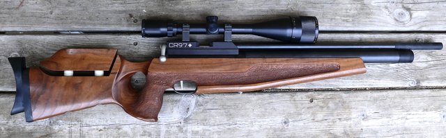

So why bother with PCP air rifles in the first place, you might ask? This is why and these are only average 50 yard groups for our Daystate PCP. Believe it or not, I've shot even better groups with it.
Oh, we could fill this great PCP rifle with a hand pump, but that would require about 150 pumps with our PCP hand pump and take well over an hour of really hard work, not counting rests in between to let the pump cool. At our age, not an option. And we will never part with this rifle, a vintage Daystate CR97.
