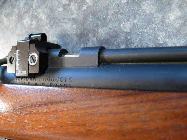

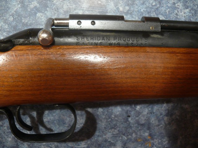

Just bought a new Sheridan pump gun in 22 and would like to put a peep sight or maybe a scope on it but can not seem to find anything on it. I am hoping to get some ideas on what I can do. Thanks in advance.

What vintage is you're Sheridan? Starting in '84, Sheridan drilled and tapped two holes for a peep sight on all their rifles. Before that, you could send your gun to Sheridan and they would do it for you. They even sent out a few with peep sights in the early days, but those are seldom seen.
Note that the two holes for the peep will be on the right side of the receiver, not the left where peep sights are usually mounted. The peep sight used is the Williams 5D SH and it's also used on Benjamin 397/392 pumps, since they use the same hole spacing and location.
Her's a pic of a Sheridan with the two drilled and tapped holes.
Here's a pic with the Williams mounted on the right side of the Sheridan. Don't see too many peeps that mount on the right side of a gun.
If your Sheridan is not drilled and tapped, it's pretty simple to do it, though, since the receiver is brass, not steel.
