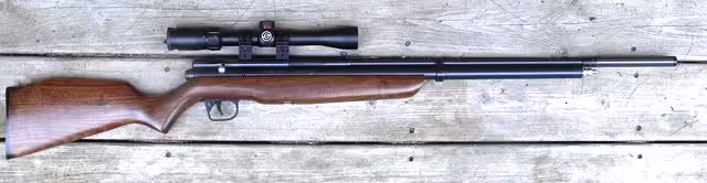

Sorry to hear the HW95 isn't working for you. Wish you were closer and I could lend you one of my PCPs equipped with moderators. They win in terms of accuracy, ease of shooting (no recoil), power and silent shooting (as long as you use a moderator) over any of my guns.
Even my old Benjamin Discovery in 22 cal would work great. I got it used for $150 and that included the Benjamin pump and an add on moderator. It gets me 20 shots per fill and close to 900 fps with standard Corpsman domed pellets. No recoil, so I can shoot it just like a 22 rimfire and it will do under an inch at 50 yards. Whisper quiet and it only weighs about 6 pounds with scope. You always leave a PCP charged when storing it, so it's always ready to go.

Have been checking PCP options. They do appear to be better built and not a bad price once you get a pump.
Any experience with the Benjamin Marauder Pistol with stock and sight? That looks interesting.

Re: What is a good nitro piston air gun for pests?
