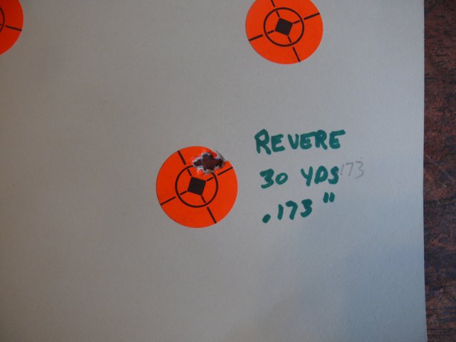

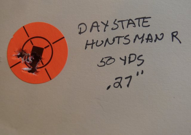

I have been doing pellet testing, I found a couple that shoot well, single hole ten shot groups, but the RWS Super H-Point Field Line pellets, in spite of looking absolutely gorgeous, gave me a 1.4” shotgun pattern At 15 yards. I really like this rifle so far. For a purely mechanical trigger it is wonderful.

John, I played around with all types of pellets in the past, but I long ago gave up on hollow points and spire points and all the other gimmicky stuff. The only thing I shoot, now, are domed pellets, except for wad cutters in the 10m competition guns.
For instance, my 177 Huntsman loves the Baracuda Match 10.65s.
