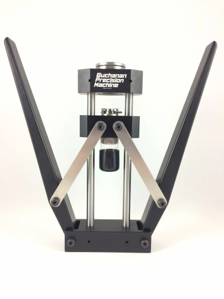

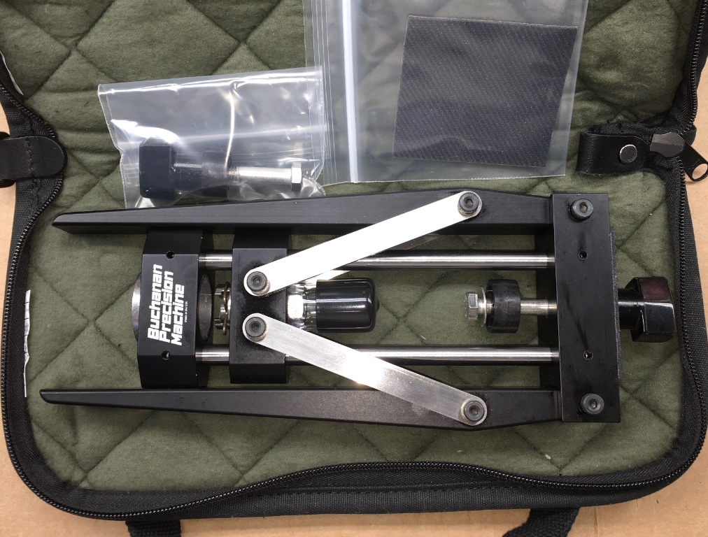

Does anyone else have one? I bought their L-N-L version with a soft carry case a month ago. Here is the press (the following two are not my pics)
https://buchananprecisionmachine.com/pr ... -with-case
If you don't know anything about these, there are a number of articles and videos. Like this one: ... https://www.thereloadersnetwork.com/201 ... and-press/ ... It is pricey but I got tired of taking my 19 pound Rockchucker along on range trips. I no longer have the hand strength needed for a Lee Hand Press. This weighs 3 pounds and is super compact. It is an absolute joy to look at and operate. The machine work is wonderful. It does use different muscles though, you press your palms together in front of your chest, as if you were praying. It uses ones I rarely use, and after resizing fifty unlubed .44 Mag cases in a carbide die, I could sure feel some soreness.

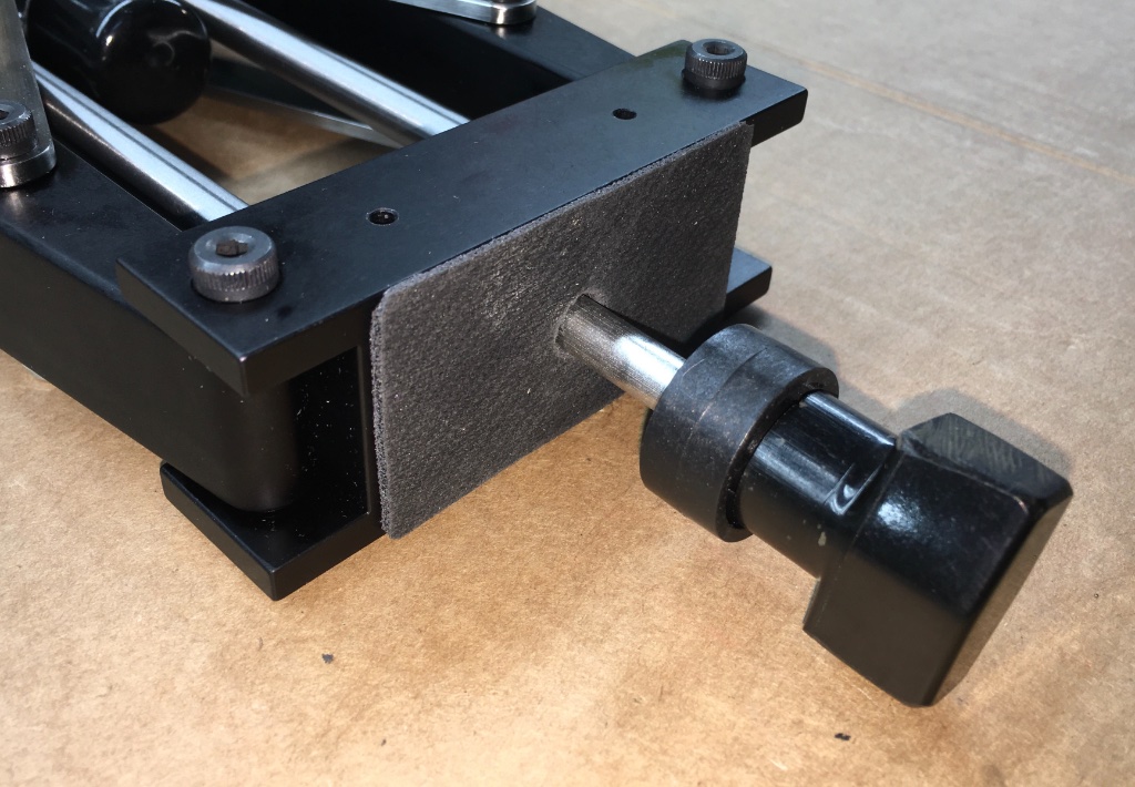

One thing I did NOT care for is the way it just sits unsecured on the table (or your lap). It is tall and top heavy, and slick on the bottom, so I was unhappy with the way it scooted around and threatened to topple over. They recommend that you keep it free for resizing, and secure it for other operations to any flat surface with a rubber padded quick release work clamp.That sort of worked, but it completely blocked access to my bench drawer, and it just seemed really really clunky and awkward.
So I disassembled the base carefully with a 1/8" DIMPLED roll pin punch, drilled a hole in the middle and now use a 5/16" stainless bolt and plastic knob. I also added some self adhesive cloth reinforced neoprene padding (from an MTM In Safe Pistol Case), so it flexes a little but doesn't rotate at all or scoot around. It all fits in the bag, along with some spares. It installs on or removes from a bench in seconds and I don't have to carry around a clamp....
The guide pin holes were burred from driving in the roll pins, they scratched the hard anodized finish and made disassembly a little difficult. I dressed them away with a small file and it went back together more easily.
The spare hardware consists of a shorter bolt, and an extra spacer and knob, so I can attach the press to work surfaces of different thicknesses.
I emailed Buchanon, suggesting that they add a third hole in the base so a buyer could decide if he wanted to use it, but he was completely disinterested. It really would add minimal cost to the manufacture process. An owner could drill the base by hand without disassembly, but I think it could end very badly ;) A drill press gives you complete control and good results.
