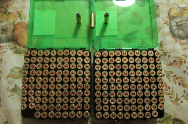

a arthritic right hand has motivated me to reduce the recoil in firing our Ruger Redhawk 44 Mag. .... to make sure I don't mix the light loads with our full power 44 Mags that we fire in our Henry, I color the primers red .... don't know that it helps to waterproof the ammo but do know it sure makes them easy to spot

JEBar, what so you use on the primers and does it flake off or build up on the firing pin area?
They are definitely easy to ID. I hear you on the hands.I keep trading off guns as they get too uncomfortable. My handguns and rifles have been getting more low powered over the last five years due to neuropathy.

red ink from a fine point permanent marker .... nothing really there to flake off
