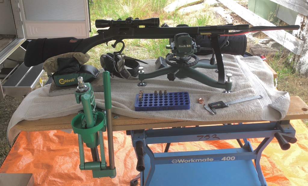

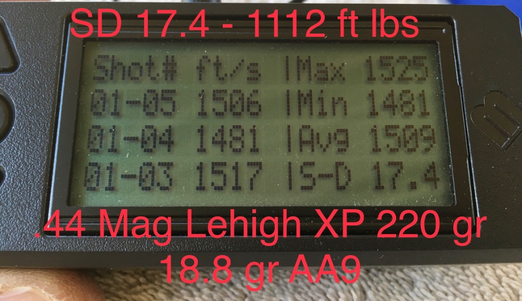

I am a big fan of all the Accurate pistol powders, I like AA9 for my hot .44 Mag bear loads. These AA powders meter especially well. I have some fun low recoil gallery loads using Trail Boss, 850 fps out of my 17.2” X barrel. It is a max load and very consistent. Here is my Lehigh XP 220 gr final results.
I like chronographing, it is fun and informative. At least now..... I used to have a CED Millenium chrono with skyscreens, cables, tripod and what a royal PITA that was to set up and operate! I now have a Magnetospeed V3. It is very versatile, compact, easy to operate and an absolute delight to use, I love it and highly recommend it. It works on a Henry, no worries.
It is really hard to take pics of this X rifle, it seems to suck up ambient light like a black hole....

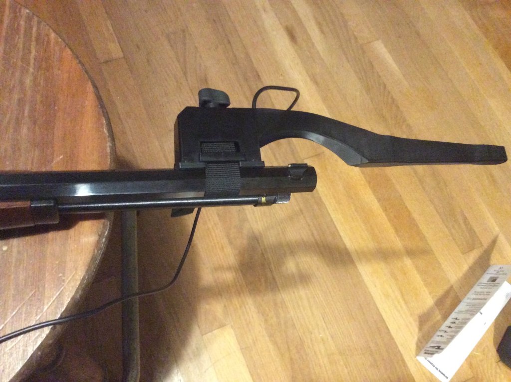

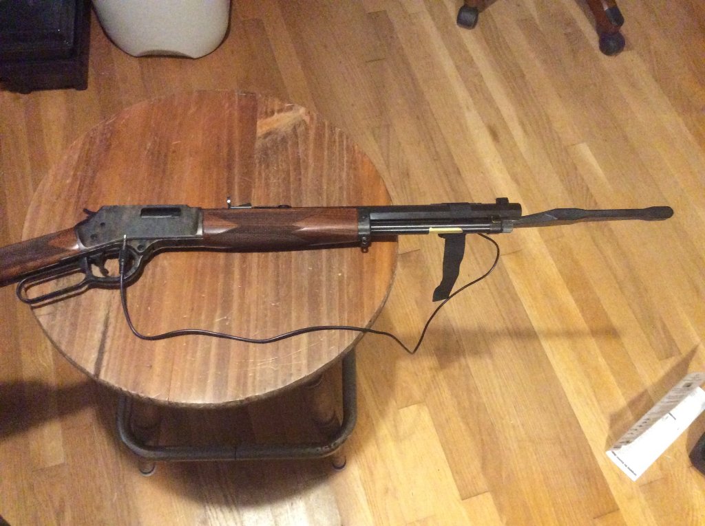

Well I have the Henry 45 Colt Carbine with octagonal barrel and have enough gap between mag tube and barrel to run the strap thru and secure it on the side of barrel. So far the Magneto Speed works really well. Think I have a picture of it on here someplace.

Love to see it 40 cause I have the same Henry and the strap is too damn thick. Take a close up for me if you would.

I will do that for you r-n-g tomorrow!

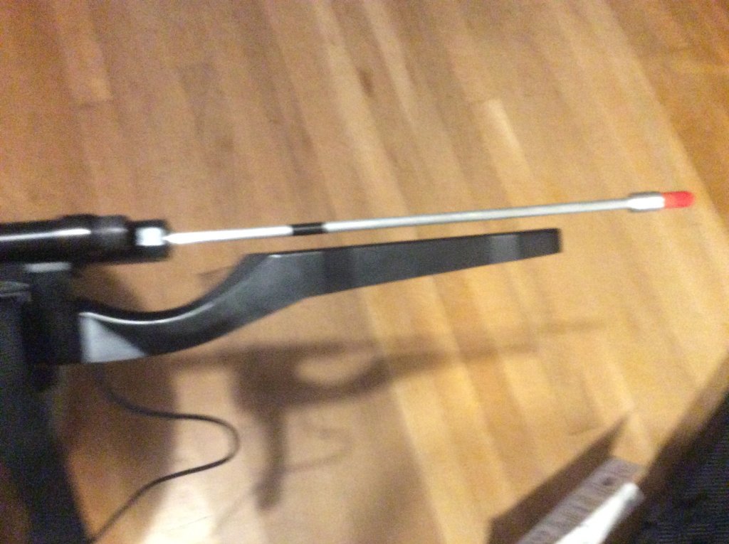

Post by fortyshooter » Wed Sep 22, 2021 11:22 am
Here you go r-n-g ! Unit installed on my 45 Colt carbine. You need .060 gap between mag tube and barrel.

Thanks Forty, I appreciate it. I don't know, maybe I need to lubricate with some Jamesons before I try again. I am going to have to pull everything out and try again.
Maybe you can wedge the mag tube slightly in the middle to gain a bit more gap. Guess there is some manufacturing variance in the mag tube gap. Mine just slips right thru.

I was to the point I was worried I was going to bend the tube.
