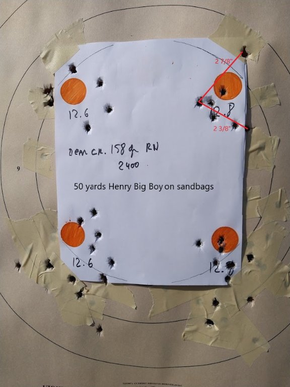

Update on what I have been feeding the big boy: I found some 2400 powder and loaded 158gr SWC coated lead that I already had. I used Lyman data for the 158gr #358665 12.2,12.4, 12.6, 12.8, 13 and 13.2gr. I thought 12.8 and 13gr were more accurate in the Henry, but they sure kick ass in the revolver. The SWC cycles a little roughly through the lever action.
Supply being what it is these days I gave up on trying to acquire some zero 158gr bullets for the time being but I found some 158gr RN coated lead. They have the same seating depth as the SWC I was using so I kept the same 12.8 and 13gr powder weight. Turns out I like the 13gr best. Maybe I will run broader ladder in the future. The round nose feeds better.

It seems to like the 158gr RN coated with 12.8 gr of 2400 best. I ran a ladder from 12.2 to 13.2 gr.
This is my best group at 50 yards. I don't know if this is good or not. My experience with rifles is very limited but I shoot groups of less than half this size with my Ruger 10/22 and bulk ammo.

Henri, that 12.8 load does look way better than the others.(upper right) You mention looking for a recoil pad; so, you must have the brass model. Are you shooting with iron sights? If so, it may just be getting used to those factory irons. Maybe try 10 rounds at 13.0gr 2400 just to see.

I am shooting with a scope.Rifletom wrote: ↑Sat Nov 14, 2020 9:50 pmHenri, that 12.8 load does look way better than the others.(upper right) You mention looking for a recoil pad; so, you must have the brass model. Are you shooting with iron sights? If so, it may just be getting used to those factory irons. Maybe try 10 rounds at 13.0gr 2400 just to see.
I had tried 13.0 and 13.2 previously but with iron sights, maybe I should revisit now that I have a scope.
