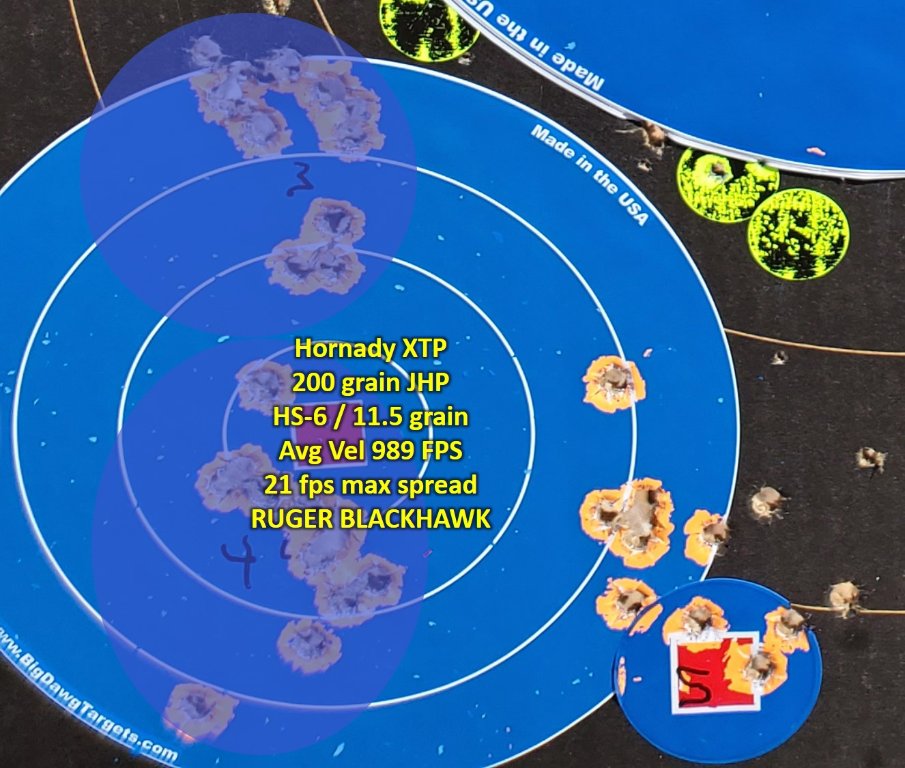

So here is how I load. For my wheel guns I stay away from cast and shoot only Jacketed bullets (I shoot cast out of my Henry though).
Wheel Guns: Ruger Blackhawk 5.5 inch barrel
El Patron 5.5 inch barrel
Below are three targets with powder/bullet/velocity info. The first two are 250 grain Hornady XTP JHP one using Unique the other with Bullseye. Velocity between the two powders was pretty consistent. the third is 200 grain Hornady XTP JHP
All three are at 30 yards from the standing position.
