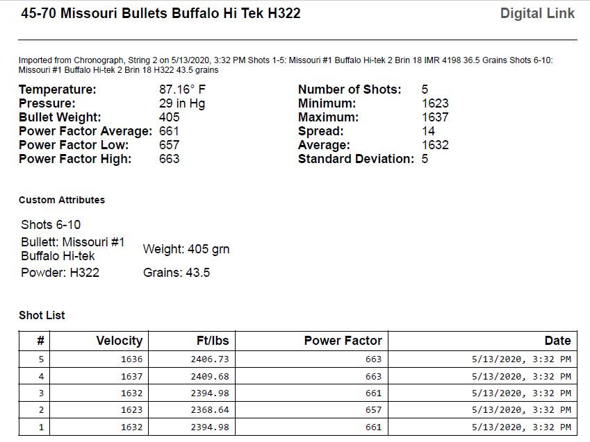

Hey Dancote, I love the Missouri 405 Buffalo High Tek for my 45/70 I load over either 36.5 grns of IMR4198 or 43.5 grn of H322.
IMR Choreographed at 1529 FPS 11FPS standard deviation, and for the H322 1626 FPS with 5FPS standard deviation.

Post by runnin n gunnin » Sun Jul 25, 2021 12:40 pm
This will give you a foundation, the H322 and IMR 4198 both patterned well, 322 a little better velocity and performance. I use Starline Brass.
The Hunters is a cast bullet I had purchased to try, by far the Missouri Hi Tek out preformed it. :
